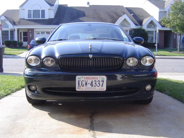

papadave, the easiest way to identify a Sport model X-Type is to look at the trim around the grill and also on the corners of the car. If this trim is chrome, then you have a standard X-Type. If the pieces are color matched to the body of the car, then it is a sport model. The below pic is what a Sport model would look like:
If you look at the picture that Five Speed has, that is what a "standard" edition would look like.
Really, the Sport model is different from a standard model in 3 basic things. The most obvious is the paint as I mentioned. The sport also had slightly different trimming inside the passenger cabin. The final thing is the Sport edition came from the factory with a 1.4" drop. So, the Sport sits slightly lower than a standard X-Type. Nothing was really added to make the car go faster and the items done to the suspension don't significantly help with cornering.

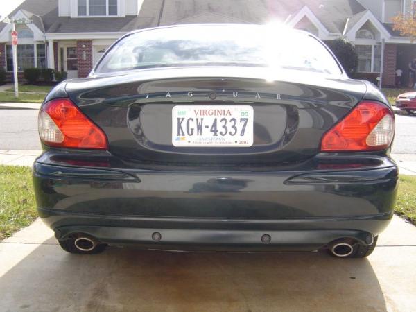

JagX02, it is very possible that someone had it painted. That is how I got my "Sport" model. I pulled the chrome off and painted it. You can tell that mine is not the Sport edition because my Growler badge is still chrome, where the Sport Edition has a color matched Growler. Same thing on the rear of the car. If you look at my trim piece above the license plate, the Sports have a 100% painted piece where mine has the "JAGUAR" left in chrome. Granted, I removed all the lettering that was back there as I think it makes the rear end of the car look a little cleaner and better looking.
