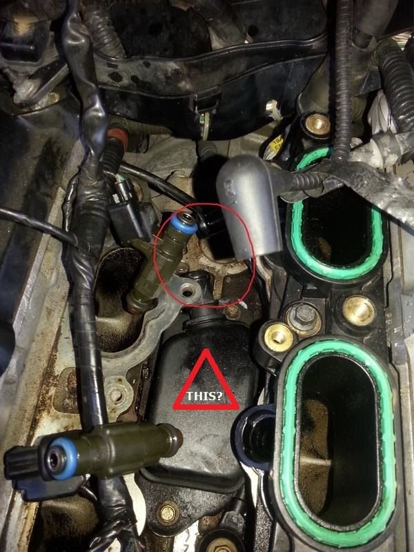

I found a picture on the internet, but I do not know, if this is it...
So this would be the view after removing the fuel rail (I don't think I had my fuel rail off before).
Is the black box, which I marked with a red triangle and the word "THIS?" the PCV oil separator?

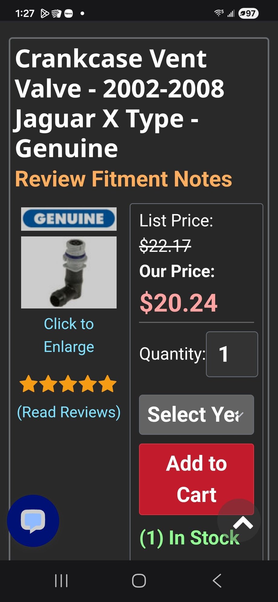

This is the PCV valve for an X-Type

These engines are Ford/Lincoln 3.0L Duratec and when I google those words with "oil separator" I see parts that look identical to what is in your picture, marked with the red triangle and "This?".
For example here:
https://www.fordpartsgiant.com/parts...-6a785-ea.html

Thanks Baltimore dh53. Good, so that is confirmed now, what and where the PCV oil separator is.
