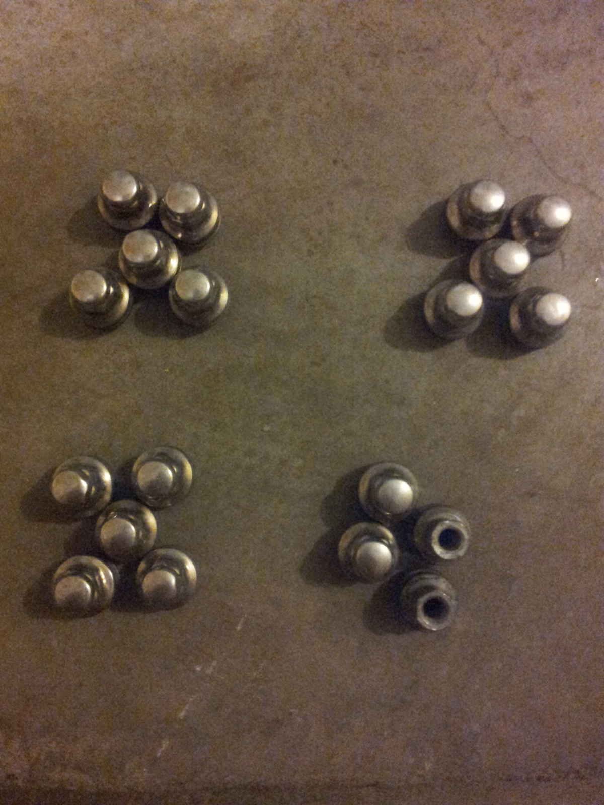

I"ll post some pics
Attached Thumbnails X type wheel studs ???-9fmolf.jpg   X type wheel studs ???-2j5dj74.jpg   X type wheel studs ???-2e0odg9.jpg

They are 3 sets an one incomplete PM if somebody is interested and we can work on the price and shipping.
