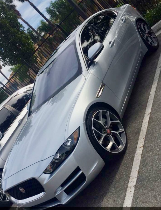

Originally Posted by Joearch
Walsha, I have a 3.5 XER sport that came with the 19" venoms. I would love to have the 20" propellers. The Jaguar dealers here are asking for $1000 for the OEM propellers which is crazy. I have been to a number of wheel dealers here in Los Angeles looking for 19" wheels that woul work with the tires on the car now. Not many options. No one seems to know what wheels would fit on the car.
I also live Near Los Angeles and did some research for rims but mostly wanted the 20" propeller rims which I ended up getting in the end despite the $1,000 Price tag each rim and still had to buy new tires. Happy with the over all look tho!
