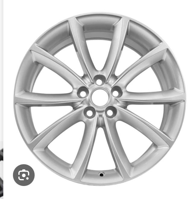

Interesting. I have propellers on my F-type, but they’re 19”. I did not think they were a different size on the XE. Here are the propellers I’m familiar with…
Edit: I’ll be darned, the 2017 XE offered 20” propellers that are completely different than the F-type 19” propellers. Go figure. Sorry for the confusion.

Ah, those are different propellers then. The XE has these:
