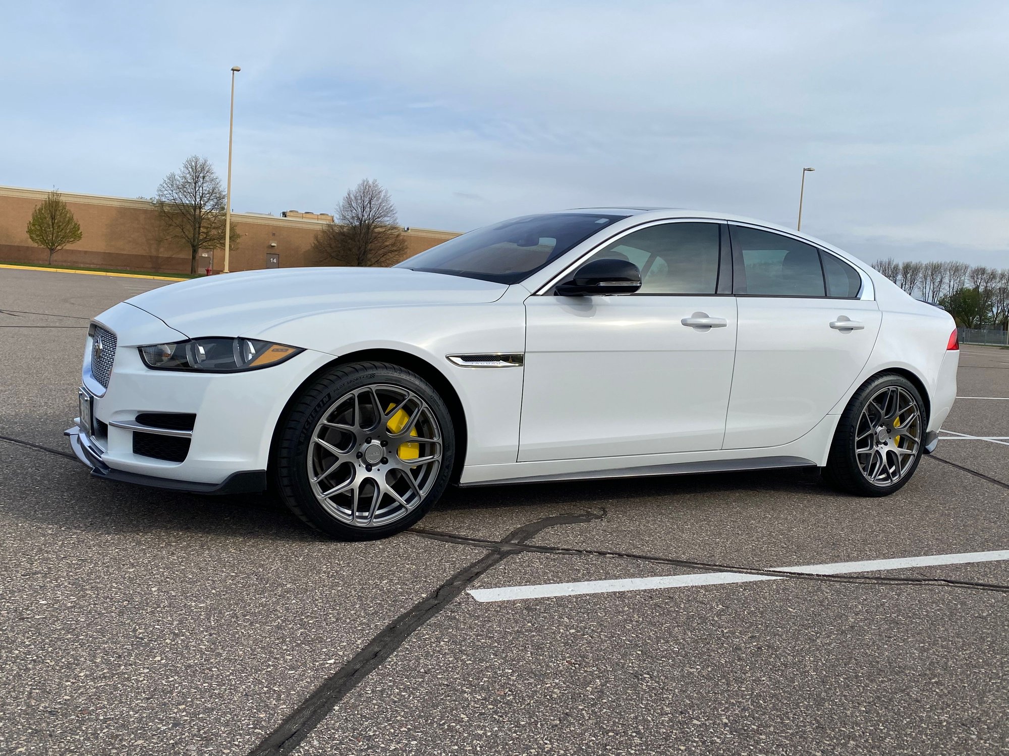

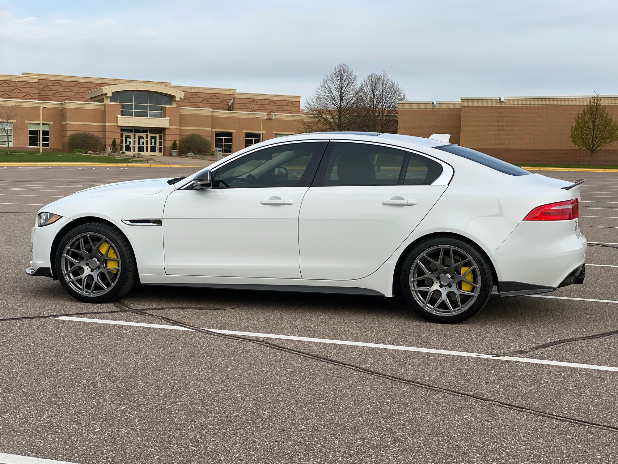

No problem. I put on 19x8.5” all around. I think the offset was 39 and I run 255/35-R19 all around with no rub or clearance issues. It’s a pretty aggressive look and the tread is right at the edge of the fender on top. I do get water thrown down the sides now though in the rain. The rear is perfect. I still don’t think I’ll have any issues if I lower it with coil overs.

They are MRR Design FS-01 flow forged wheels. I contacted MRR and they referred me to one of their top dealers,Element Wheels in Chandler, AZ. The FS-01’s are custom made to order from blanks with a ton of finish options. They take about two weeks from the time you order.
