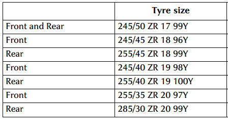

EZDriver according to the Jaguar specification those are the correct size/rating of tires.

The staggered wheel/tire sizes are normal except for the 17" wheels.
The rears are not just a larger tire, the rim itself is wider.

Rims AND tyres. The difference isn't about diameter or circumference, it's about width - wider rims and tyres at the rear for better traction.
Not totally sure of my facts here, but I don't think you could put a 255 tyre on to an 8J rim or a 245 tyre on a 9J rim.
You could fit 8J rims (245 tyres) all round, but you could not put 9J (255) rims on the front as they would probably foul the wheelarch on full steering lock.

XKR's came with 9" wide wheels with 255 wide tires on the front from the factory (20" option), so that should work fine. Even better with 255/40's which are shorter than the factory 20" setups.
255/40R18 or 255/45's's will fit fine on 8" or 9" rims, so if you wanted one tire size, either of these would work. You still couldn't rotate them without looking dumb, but it should still handle OK and either would fit front and rear.
I've seen no evidence an XK8 really needs larger tires in back and probably handles better with the same size tires all around.
