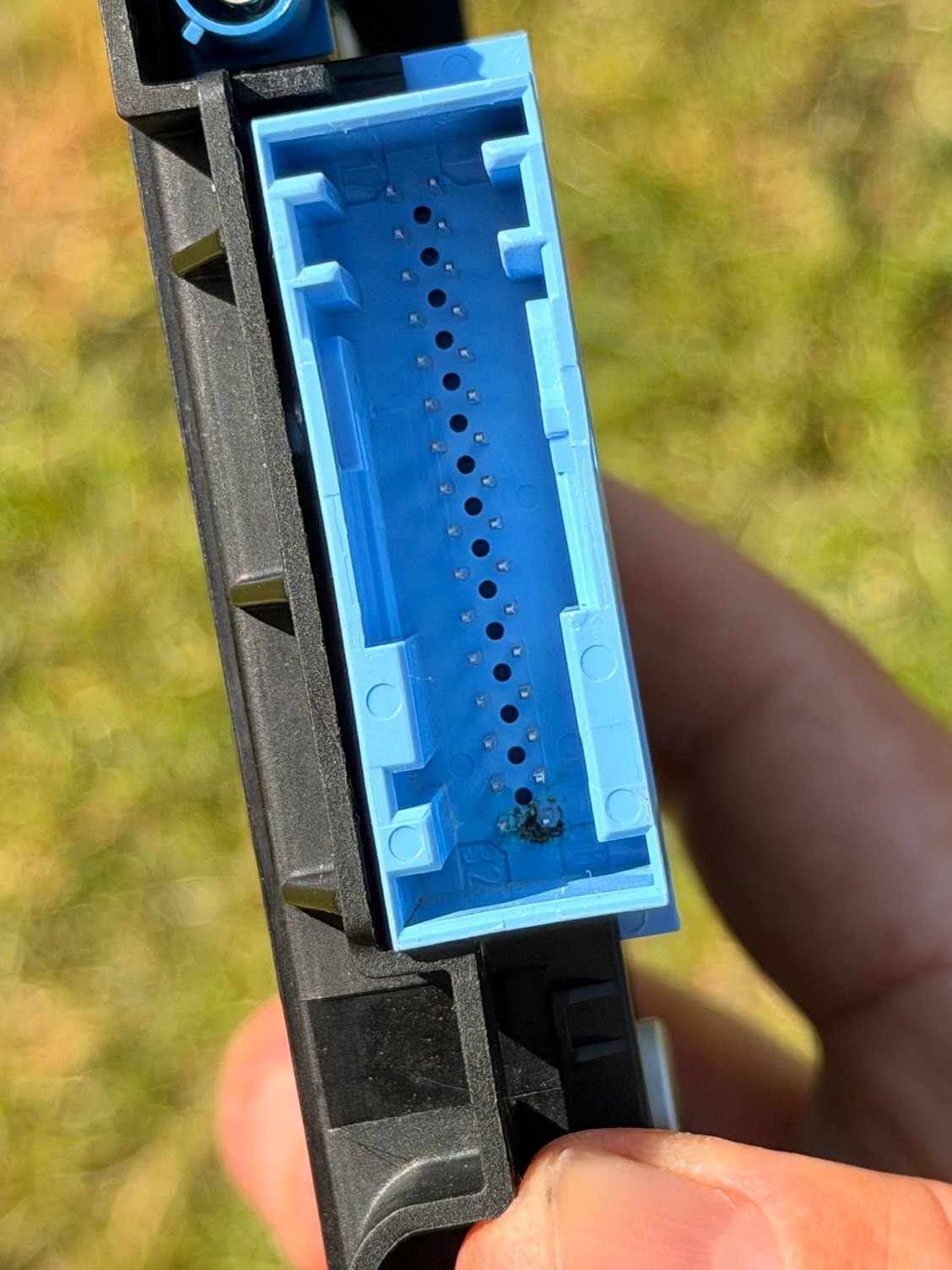

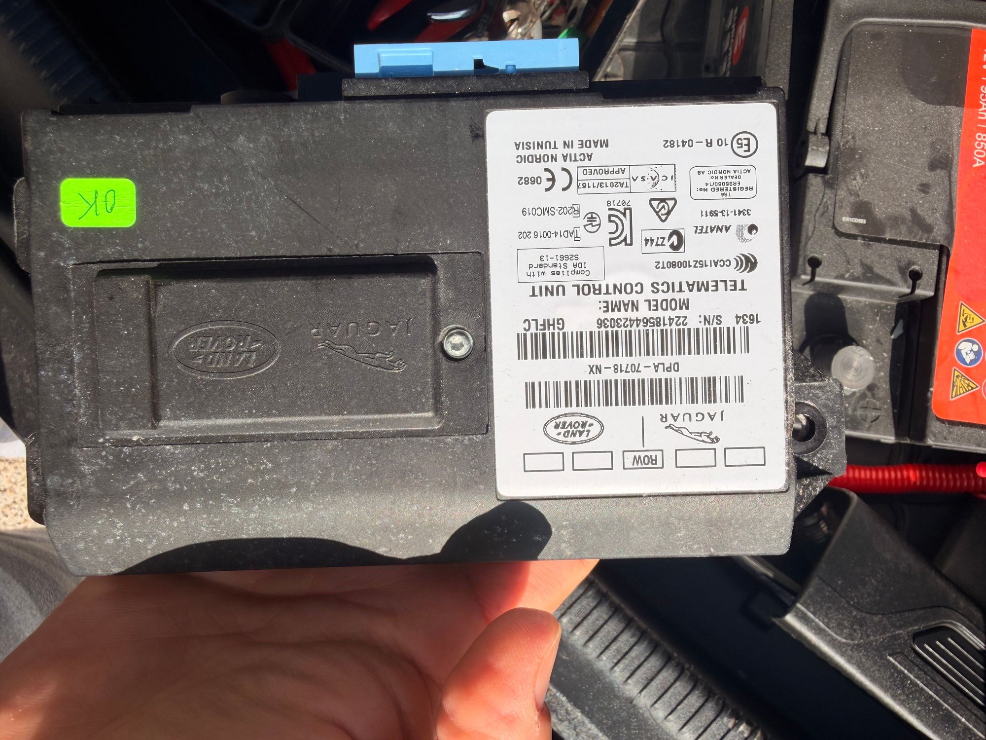

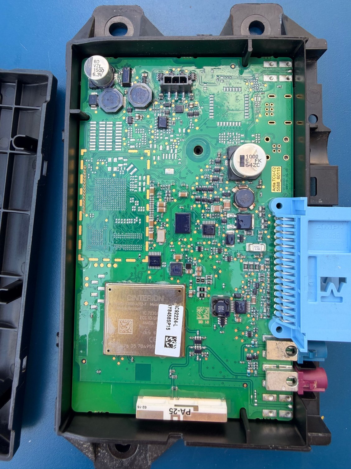

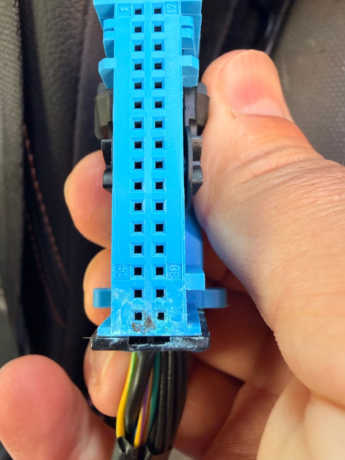

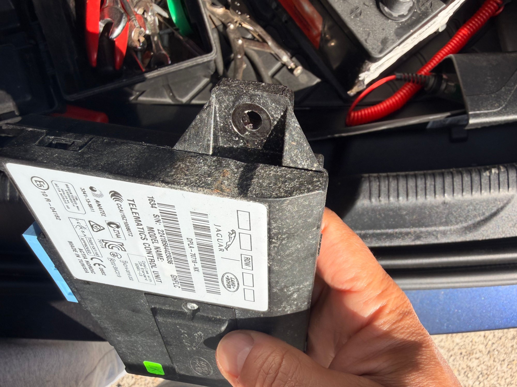

I’m reaching out because I’ve seen your expertise with JLR systems. I’m struggling with a TCU-related 'No Crank' issue on my Jaguar XE.
The Situation:
  • Errors: 'SOS Limited' and 'SOS Unavailable' (intermittent, but now persistent).
  • Hardware: I found oxidation on the TCU board and a leaky/loose shark fin antenna.

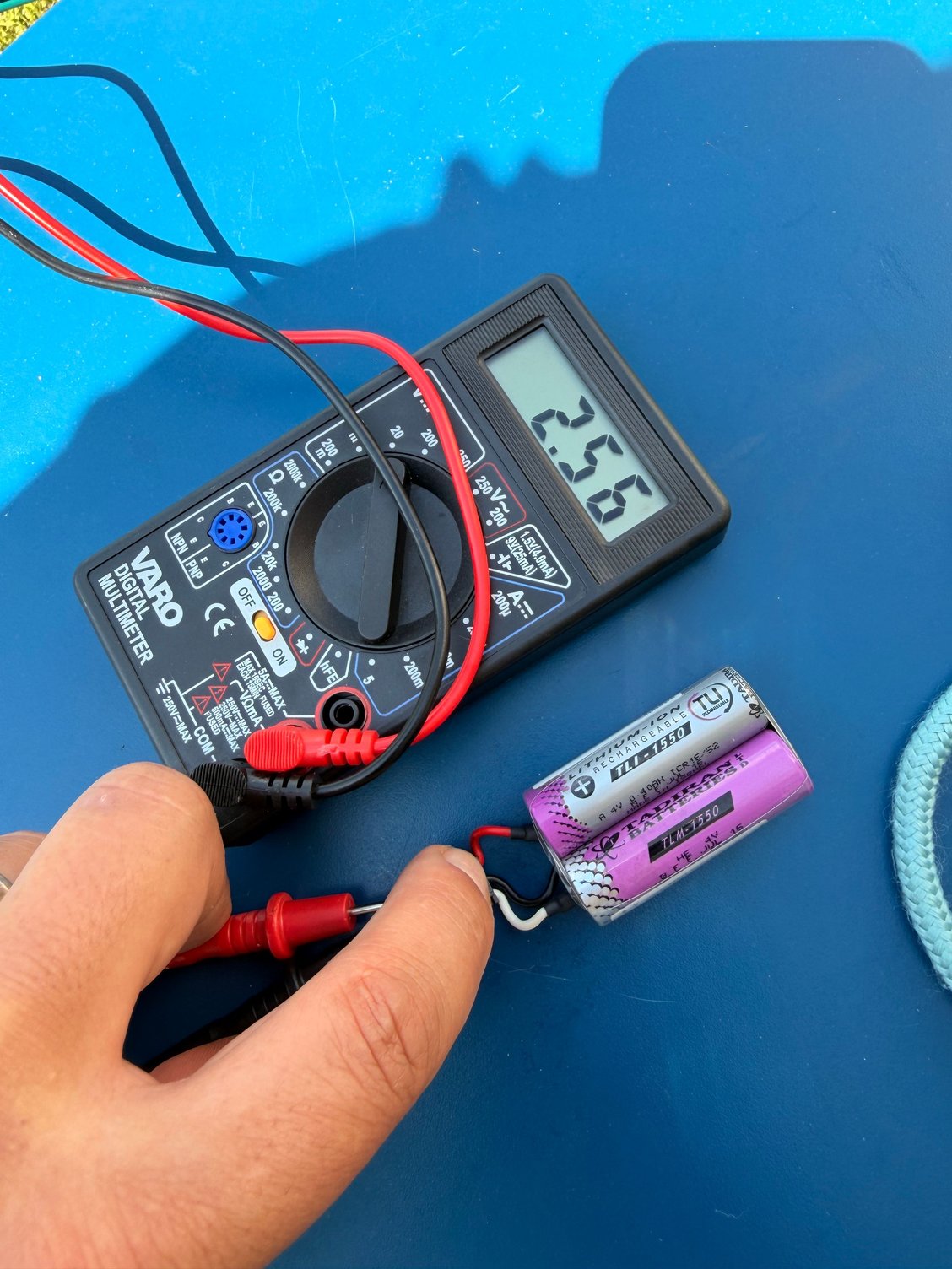

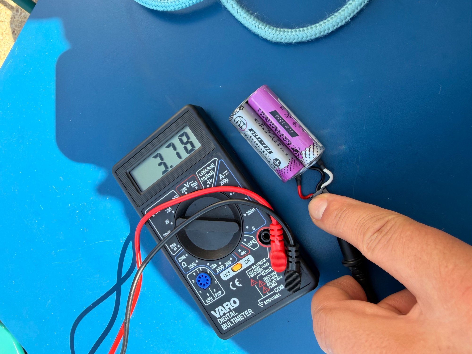

  • Battery: The backup battery was imbalanced (one cell at 2.5V, the other at 3.7V). I'm currently пытаюсь (trying to) rebalance/charge it on a bench.
  • Goal: I don't care about the Telematics features. I want to either fix the communication to restore cranking or, preferably, code the TCU out (CCF delete) for peace of mind.
Since I'm in France, do you think rebalancing the battery will clear the 'No Start' if the PCB is cleaned? Or is a CCF edit the only reliable permanent fix?

If you can clean it and get the communications back with the module, it would start. The backup battery and other faults won't stop it from starting. If you cannot get the module to be back online and communicating properly to allow the start signals, then yes you would need to have it coded out.
