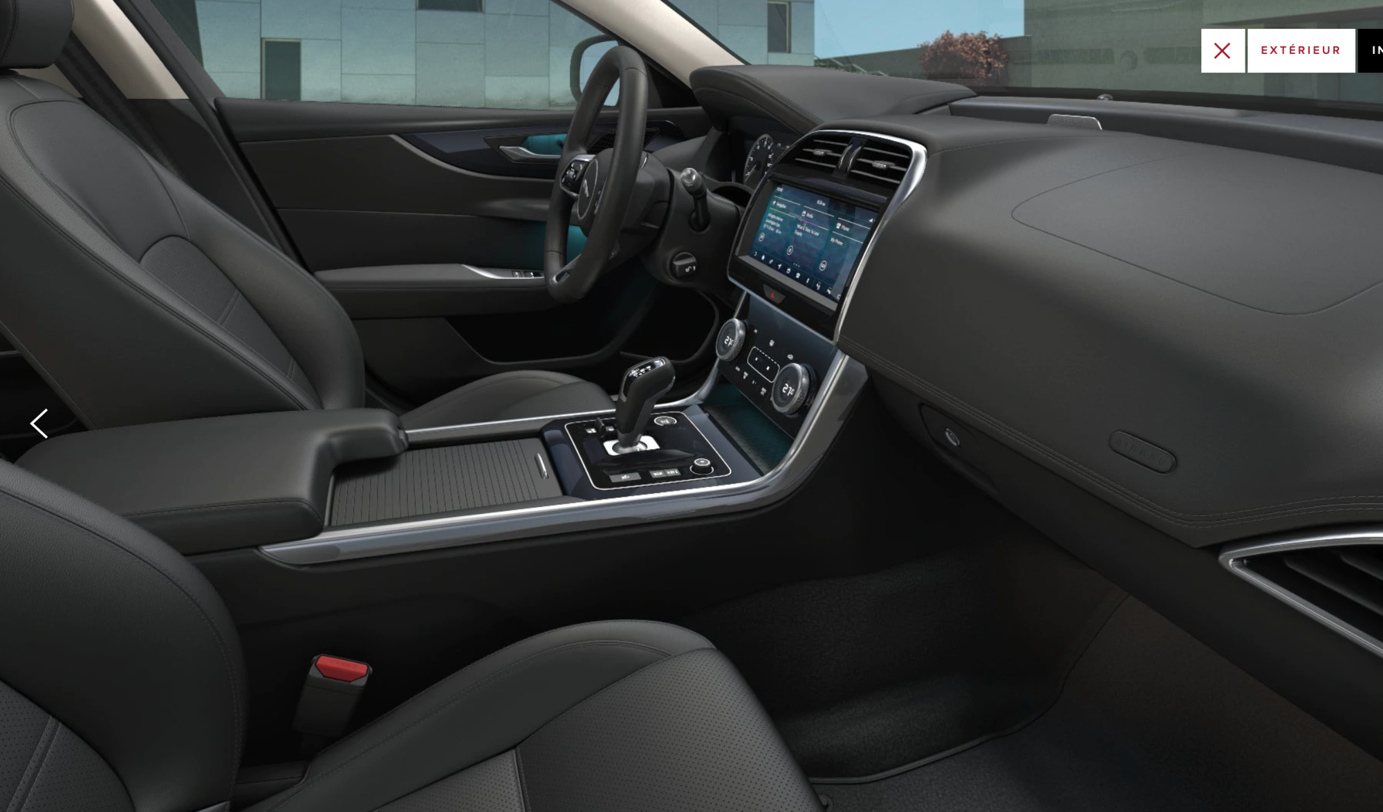

Off of the jaguar France website (translated into english for me), paddle shifters are an option on the base car. It looks like they are standard on the r dynamic variant. You can also see on the photo that they are not there. It seems odd you cannot manually shift with the shifter however.

I think the issue has been with the JLR XE online configurator.
Up to model year 2019, plastic paddles came as standard with all but the lowest trim option. The configurator offered satin metal paddles as an extra cost option.
However, from MY 2020 the plastic paddles have been deleted but the configurator still offers satin metal paddles as an extra cost option. So it is easy to erroneously assume that, if you don't go for this option, you'll still get the plastic paddles.
You have to look very carefully at the interior illustration on the configurator to notice that there are no paddles unless you select the option.
I did notice this when ordering my MY2020 XE and I must say the satin metal paddles that I ordered are good to look at and work very well (better I think than the paddles in earlier model year XEs).
Sadly, I think that adding them to an already built XE might be quite complicated (and no doubt expensive)
