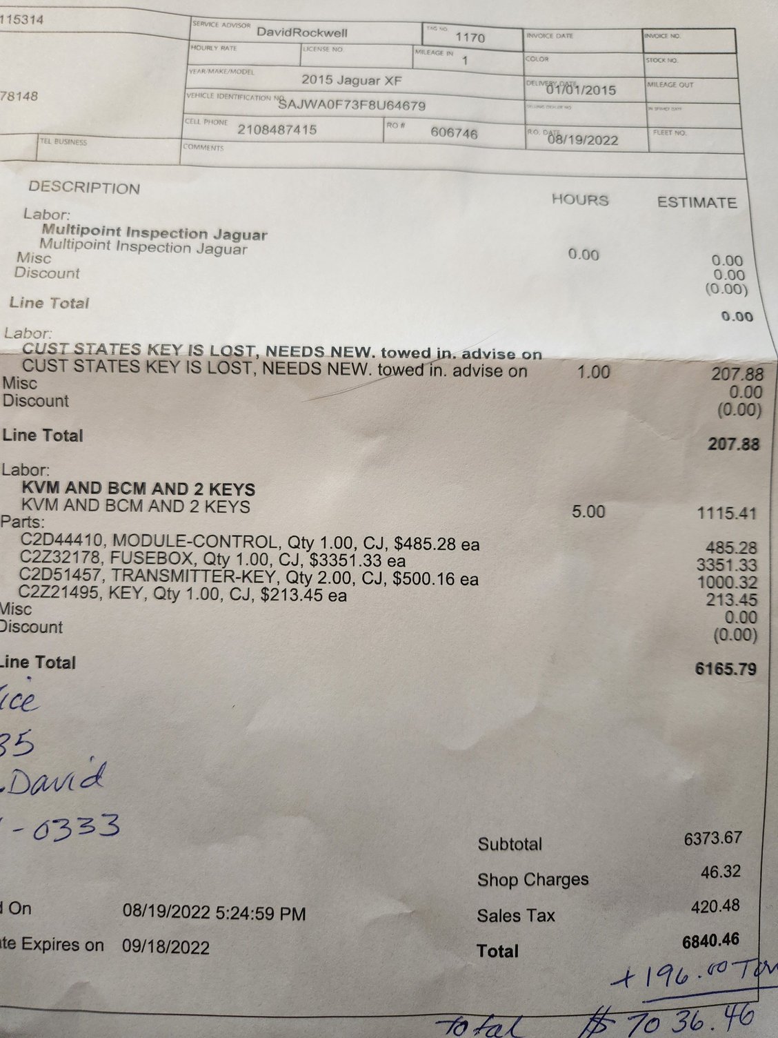

Thanks for the responses. This is the quote, broken down. The excuse is the fuse box and control module will 'lockdown' and have to be replaced if they open the car without a key. I am going through insurance so I don't really care so long as I get a fully functioning Jag back:-) I was just curious to know if every Jag owner that loses the keys have to go through the same deal.
I had it towed to the closest JLR dealer in San Antonio because their parts department said they had keys in stock and I was fully prepared to pay $750-$1000 to get one and have it programed before all this happened. Incidentally, the above quote doesn't include cutting the metal key inside the fob. Oh no, they have to send them to England for that:-)

Thanks for confirming JLR also supply cut key blades to US Dealers. I didn't know if that was just for Europe.
I would query necessity for the Control Module and seriously question the Fusebox replacement as they should be able to synchronise these and the new Smartkeys. However, as Fraser so colourfully observed, they have you at a disadvantage.

Quote: The excuse is the fuse box and control module will 'lockdown' and have to be replaced if they open the car without a key.
Unless they have an explosive self destruct inside I do not see how they will be unusable.
When such items are manufactured they obviously need programming when fitted to a new car. There is no engineering reason they cannot be programmed a second time.

Wow, that is a crazy price. Glad I have 2 keys for mine just in case. As an FYI, we also have a 2016 MB C300 and lost the only key we had. It cost $800 to replace and program the new key. They have some type of master codes which can be looked up and then programmed. The dealership we used only had one person who was allowe to do this.

You said you're at the San Antonio dealership primarily because someone mentioned they'd have in-stock benefit---and so far San Antonio disappointed you on that. You also don't seem to have any past dealings with them, so they have no earned faith or good quality standing with you yet, AND it seems to most of us posters that their foot is down heavy on the "profit pedal".
I'm sorry, but I wouldn't want to reward San Antonio with the chance to work on my car and make money. Especially if they have to (NOT PROVEN yet, until you talk to JLR directly) go drilling holes in my car and frying-out circuit boxes.
Even if yes, JLR says the drilling and electrical replacements must be done, ... I'd still be willing to pay extra towing to get the car from San Antonio to another Jaguar dealership (maybe the dealership you've been going to regularly and feel more solid about). Your Insurance company will understand---they secretly LIKE for a customer who saves them a bit of pay-out money by being shrewd with dealerships.
Please talk to a JLR rep---it's THEIR car, not the dealership's. In the past JLR has altered the key fob dynamics to address common slips and user oops they found customers were falling into, so JLR may have a procedure all mapped out to cut blade-keys in their own shop (and maybe leave the car locked and undrilled in your own driveway).
