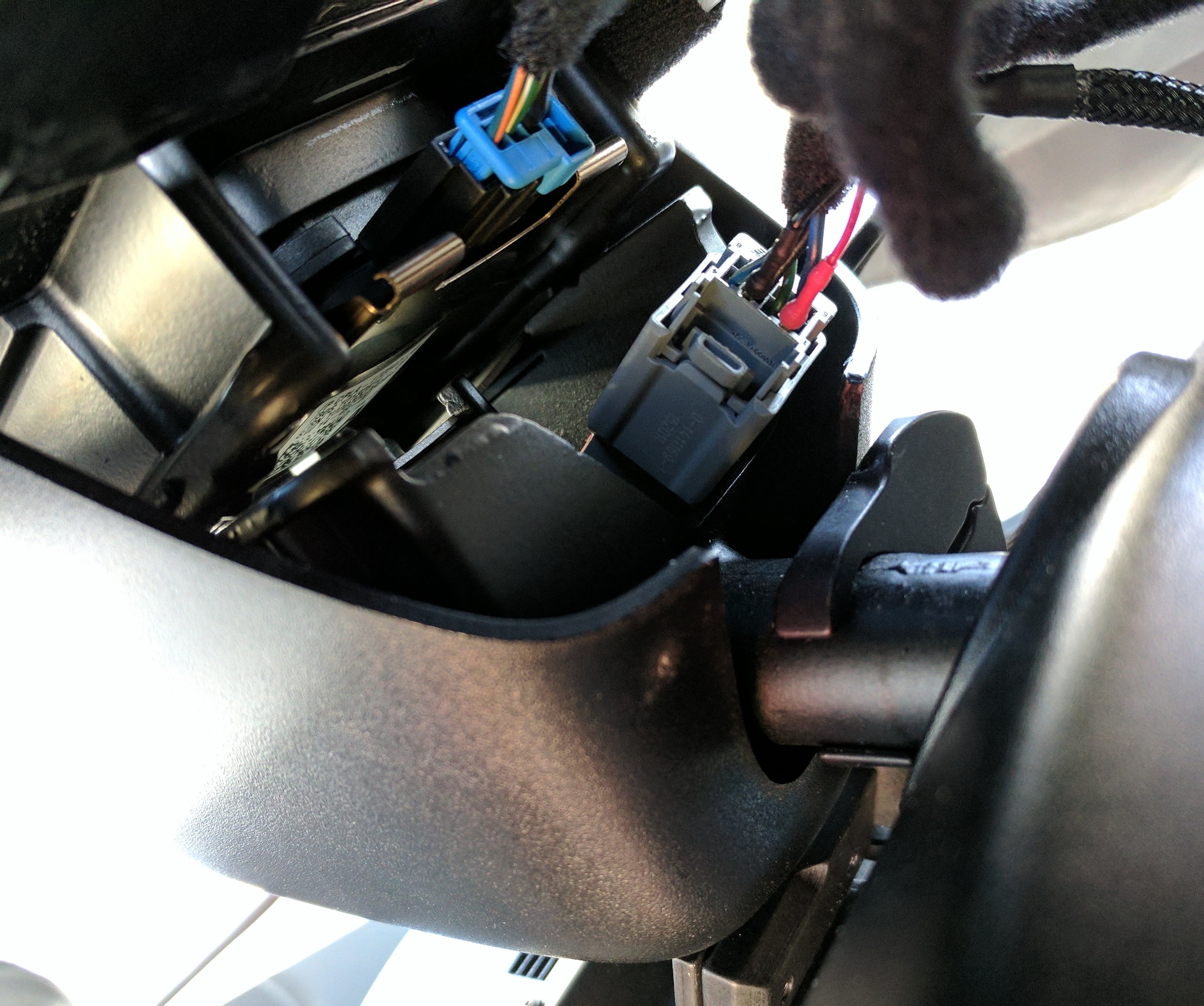

Has anyone tapped into the overhead lighting section for power for a DVR or radar detector? Deets, please...

Yes, and it's not too difficult. There is a wiring harness inside the shrouds that make up the rear view mirror / sensors part of the interior windshield. There are two shrouds and they both "pop" off with a bit of effort. I bought the tap off of amazon.com:
Amazon Amazon
This is specific to my Valentine One detector, so yours might be different, but the principle is the same. It comes with detailed directions to help identify the correct wires using a multimeter. Really easy.
I mounted mine under the rear view mirror using a Blendmount mounting bracket - www.blendmount.com, although I think I may need to move it. The detector is not acting like it used to in my old vehicle. It doesn't pick up signals from the front in the same way it used to. Doing some research, I may have Solar Attenuating Glass" on the front. I say "may" since I see it in the manual, however the dealership has never heard of such a thing. I don't have the heated glass so there must be something else going on. I think I need to follow the mounting locations for Toll Road payment cards or RFID devices (up high and very near the rear view mirror).
Anyway, check out the photos and let me know if I can help:
Attached Thumbnails 12v tap for dash accessories-jag-tap-1.jpg   12v tap for dash accessories-jag-tap-2.jpg

Yes, you need to move your detector to the dotted area's (right/left of the mirror). You'll get better reception although still not like you probably had in the past.
