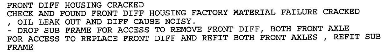

I wanted to share my story with you all and see if anyone else had a similar experience (2016 Jaguar XF R Sport AWD with 26k miles at the time of the incident).
In Feb 2020, I was on my way to work and a few miles from home, I heard a terrible grinding noise and my car went from 35 mph to 0 in a matter of seconds, it felt like I had run over a small car and it destroyed my under carriage. Car refused to move more than an inch in either direction. The front wheels were locked up, tow truck had to drag it up on the flat bed.
Gets to the dealer, and find out that the entire front differential is cracked from an interior malfunction (don't know much about exact workings), but was told that a part failed inside and pretty much exploded the differential from the inside. There was no previous warning of any abnormal sounds or driving issues, literally came out of the blue. Car was serviced exactly 2 weeks prior for CEL and replaced a bad O2 sensor.
Long story short, it took three weeks to get the parts from the UK and my car back.
Driving like a dream now, 6 k miles later, but I will always have that worry in the back of mind of my transmission blowing on a busy highway.

Sorry for the troubles but silver lining it happened under warranty..
For this guy, not so much..
Search:
March 31, 2020
NHTSA ID NUMBER: 11319887
Components: SUSPENSION
