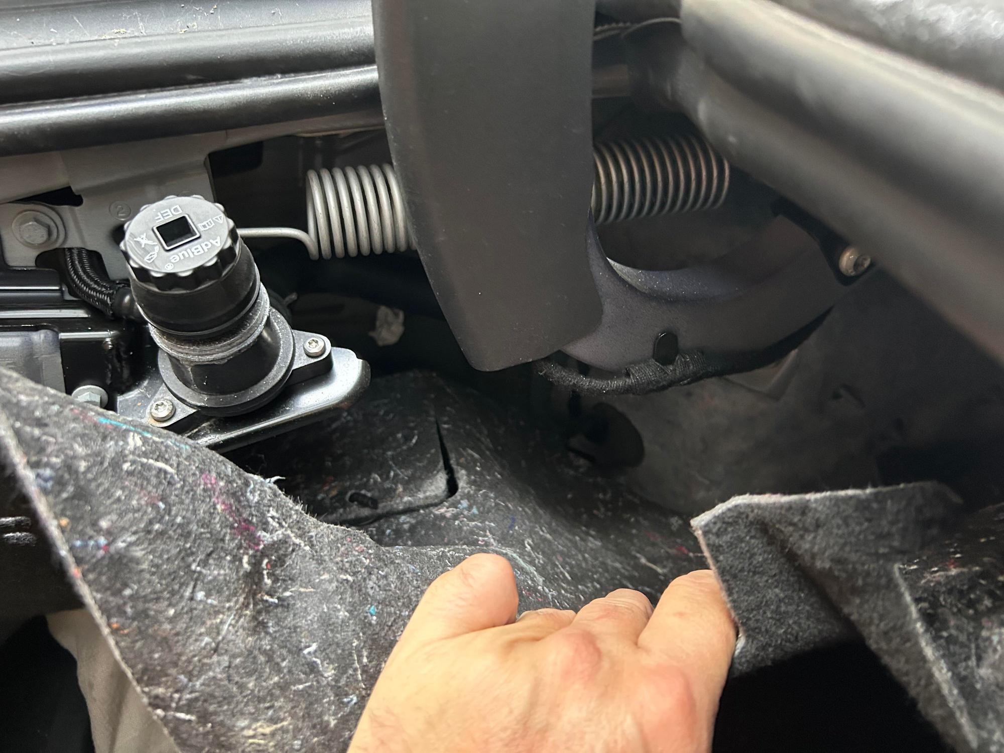

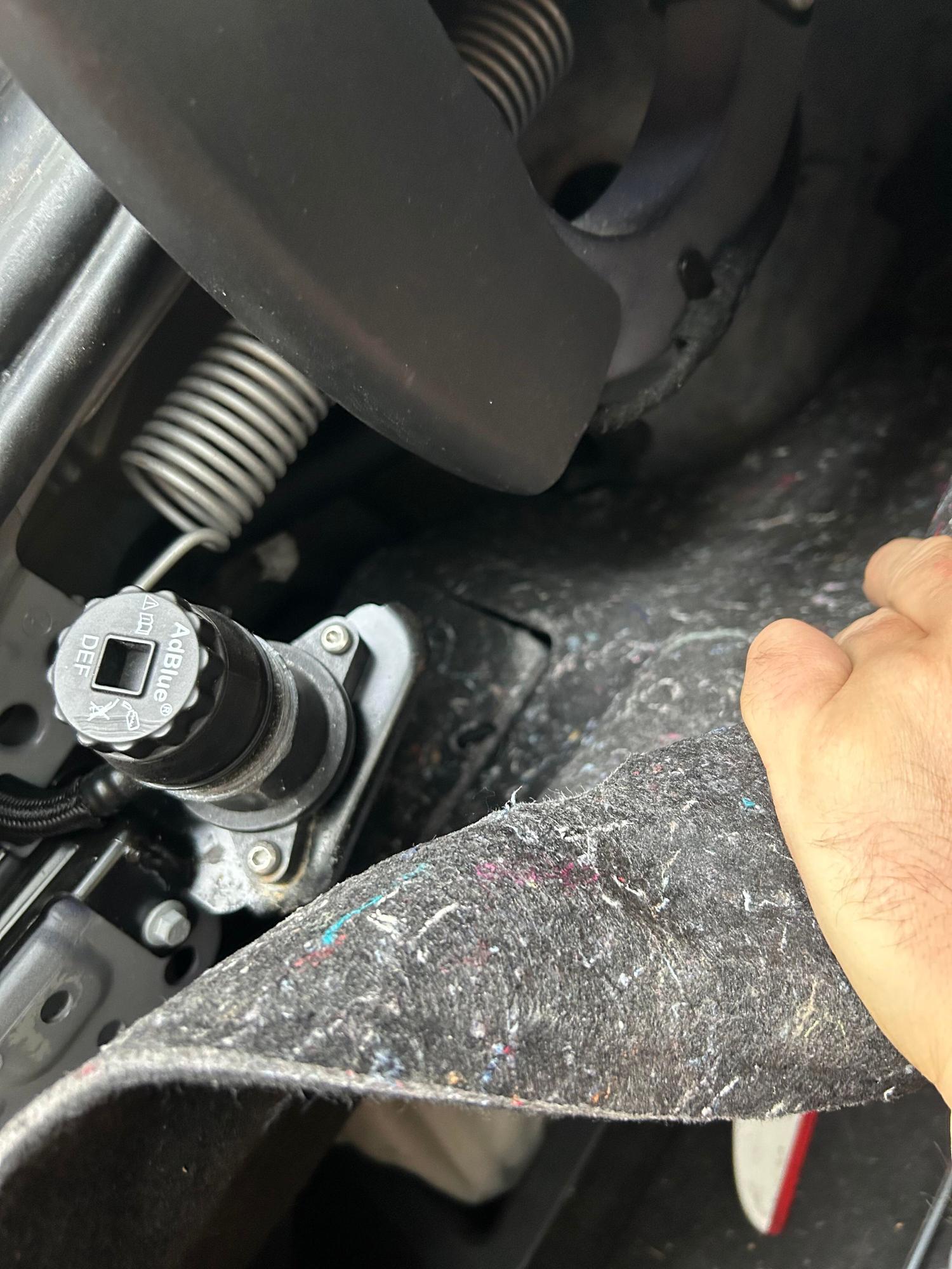

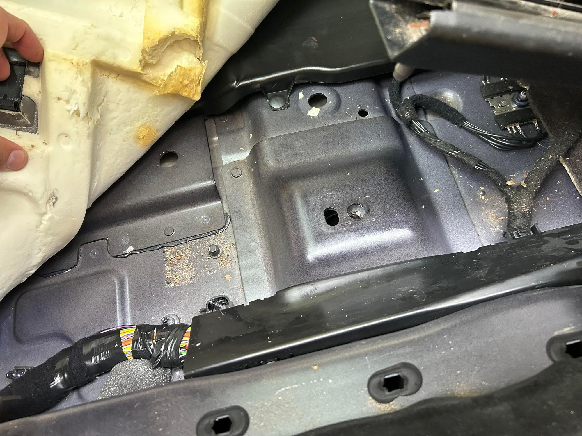

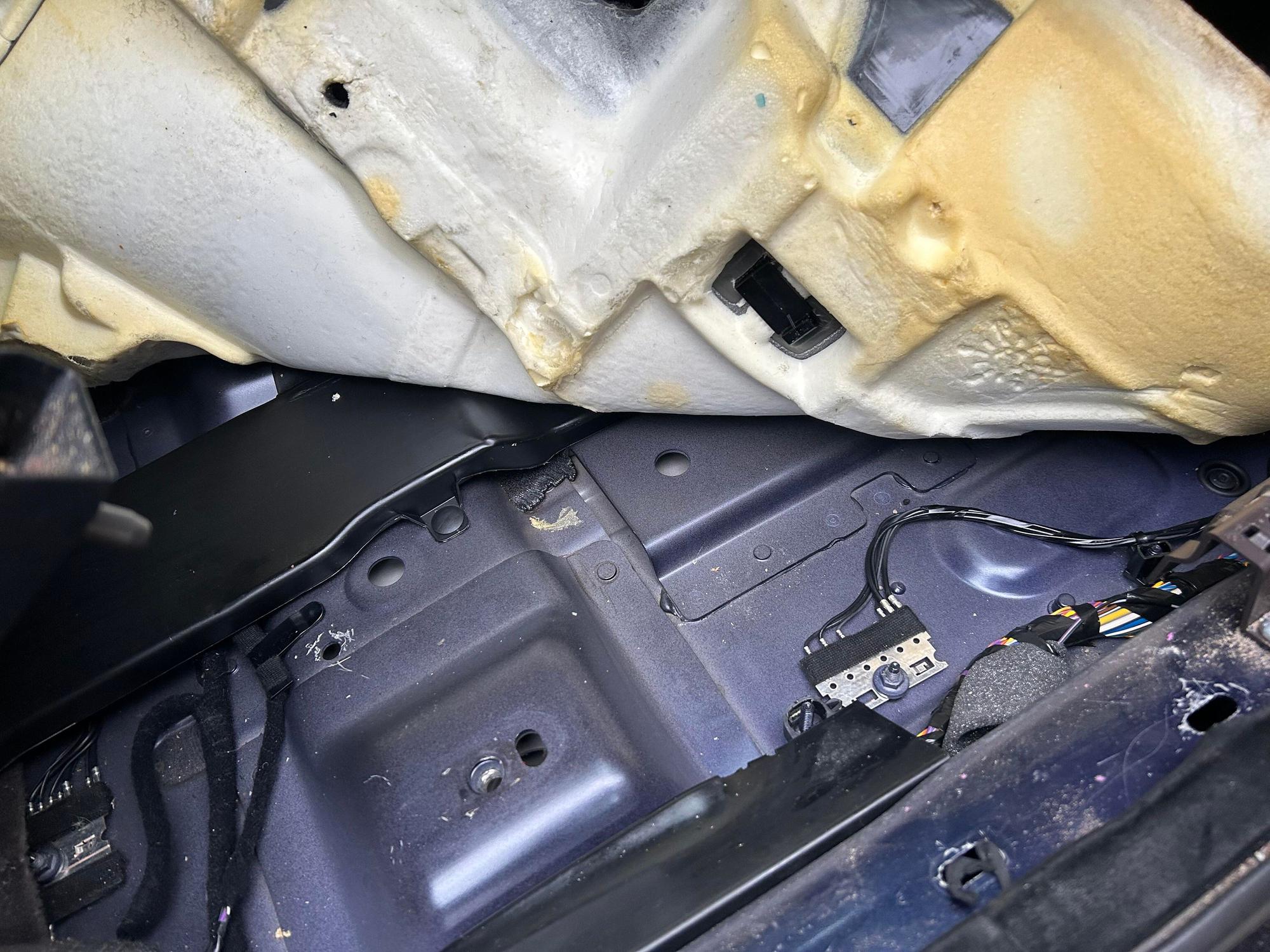

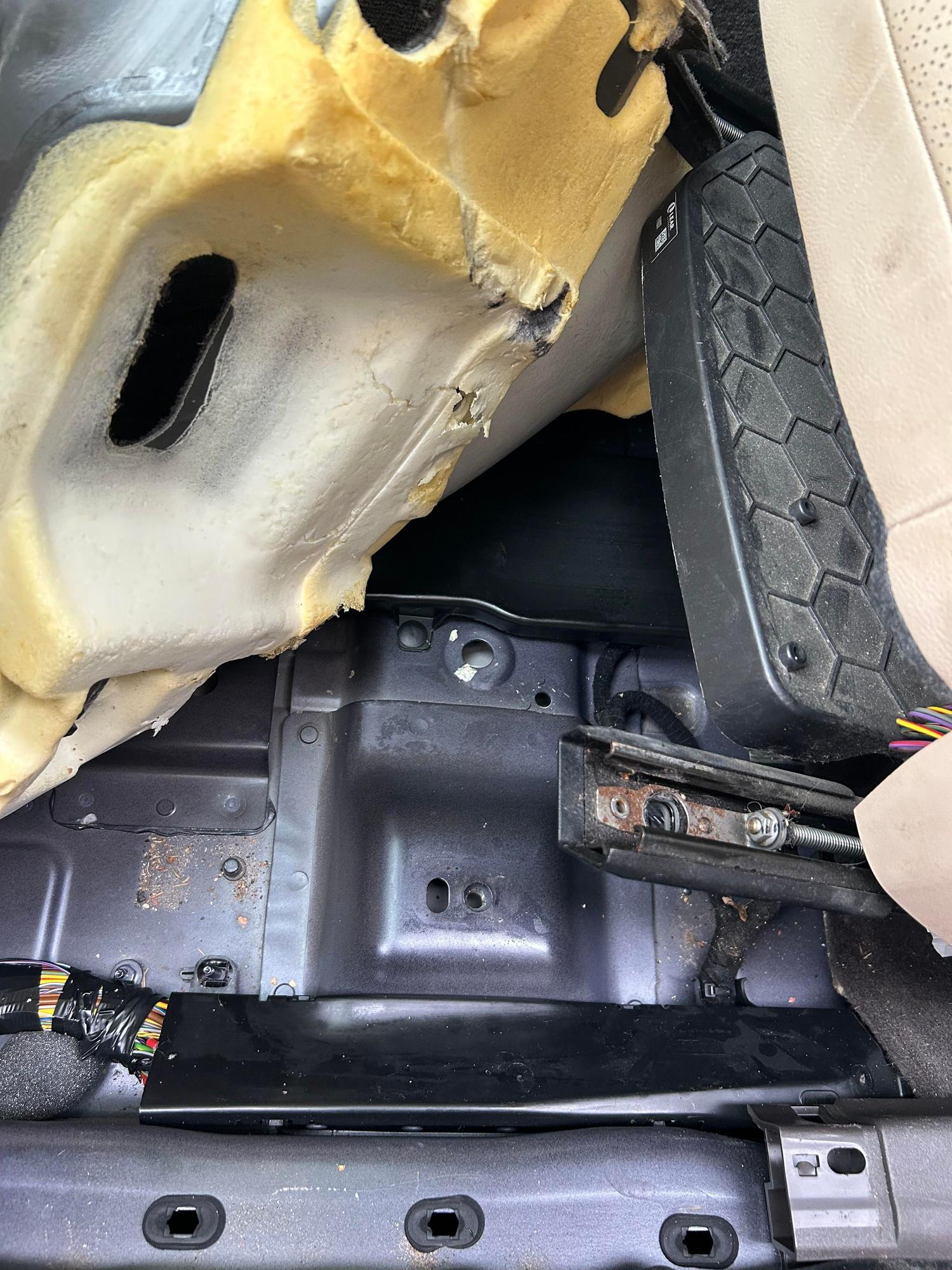

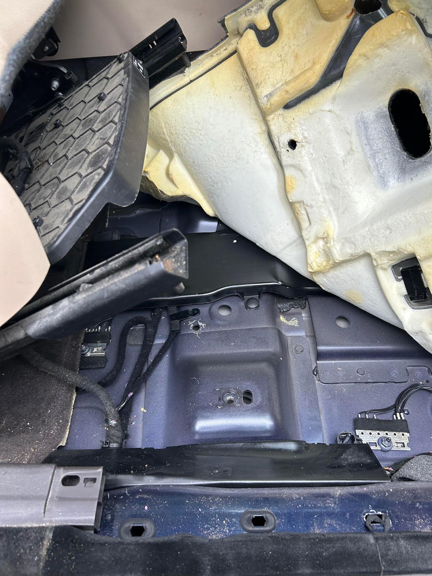

After 2 years of watching the screen constantly reboot , and finding no clear information about the Jaguar XF X260 model, I decided to check under the seats to see what the Bluetooth module looks like – like in the YouTube videos where people fix the endless rebooting screen issue.
But in my case, whether on the passenger or driver’s side… there is nothing there. I also checked in the left side of the boot, and again, nothing.
Left seat (passenger in UK)
Right seat (dirver in UK)
Left side of the boot
So now I don’t know where else to look. My car definitely had Bluetooth before this problem started, so the module must exist somewhere. But I’m not even sure if replacing it would fix the problem, because it feels like the wiring and the fix are completely different compared to the XF X250.
All the youtube videos dealing with this issue are about the X250 models from before 2010, while mine is a 2016 (X260). So I’m stuck, if I can’t find a solution, I’ll have to go to a Jaguar dealer, but I’m afraid they will just replace the whole unit and it will cost a fortune, when I could maybe find the part on eBay for much less.
Thanks for your help
