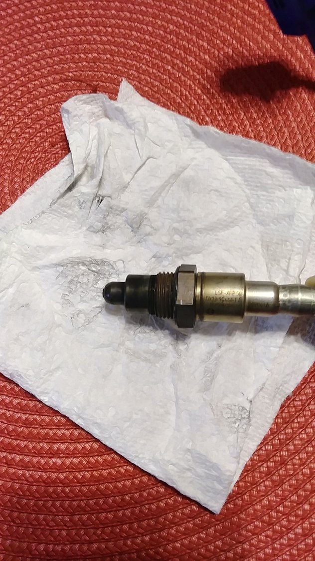

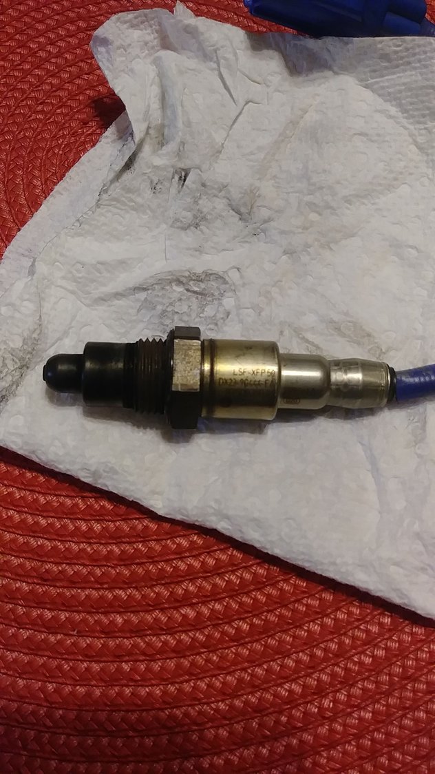

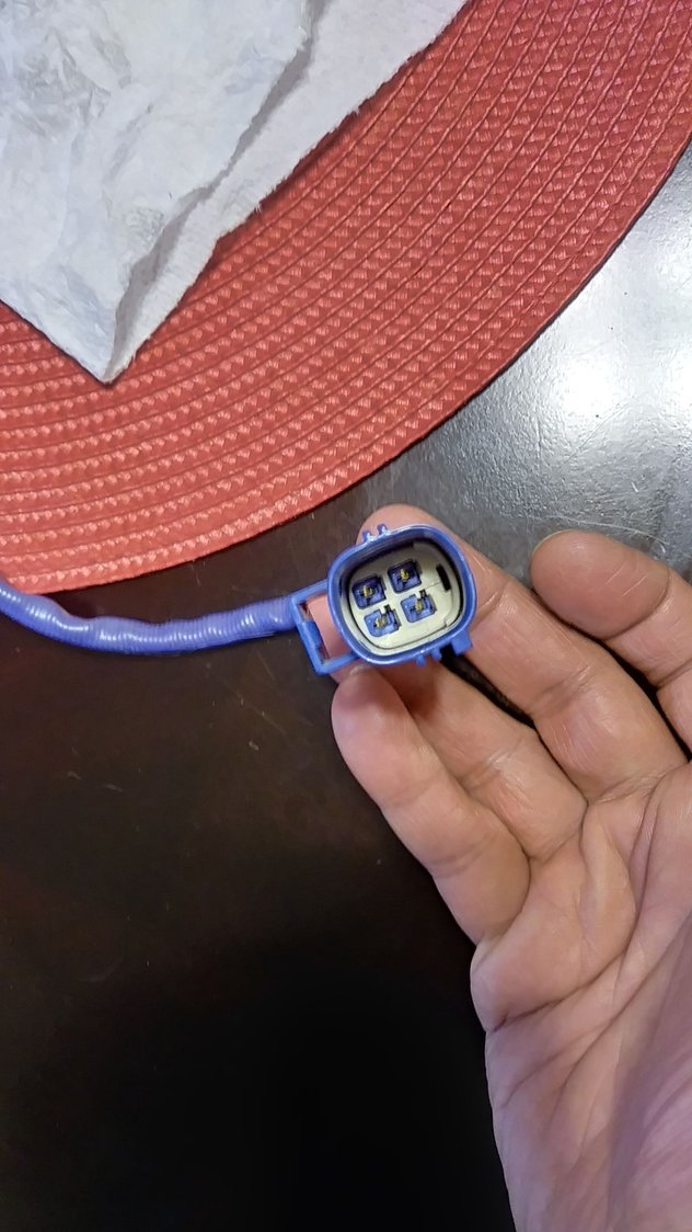

Downstream O2 sensor was very easy to remove.
Both right and left (Bank 1 & Bank 2) sensors are identical. Numbers on the sensor are LSF-XFP50
DX23-9G444-FA. 0258030034
209061A
Made in Germany
Bank 1 sensor 3 LSF-XFP50 DX23-9G444-FA

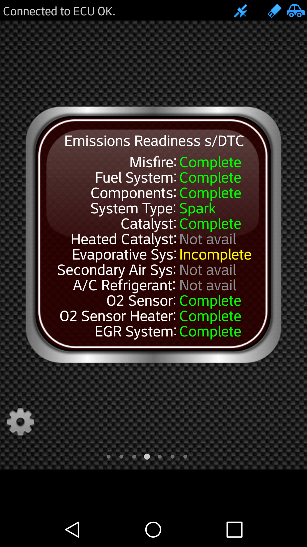

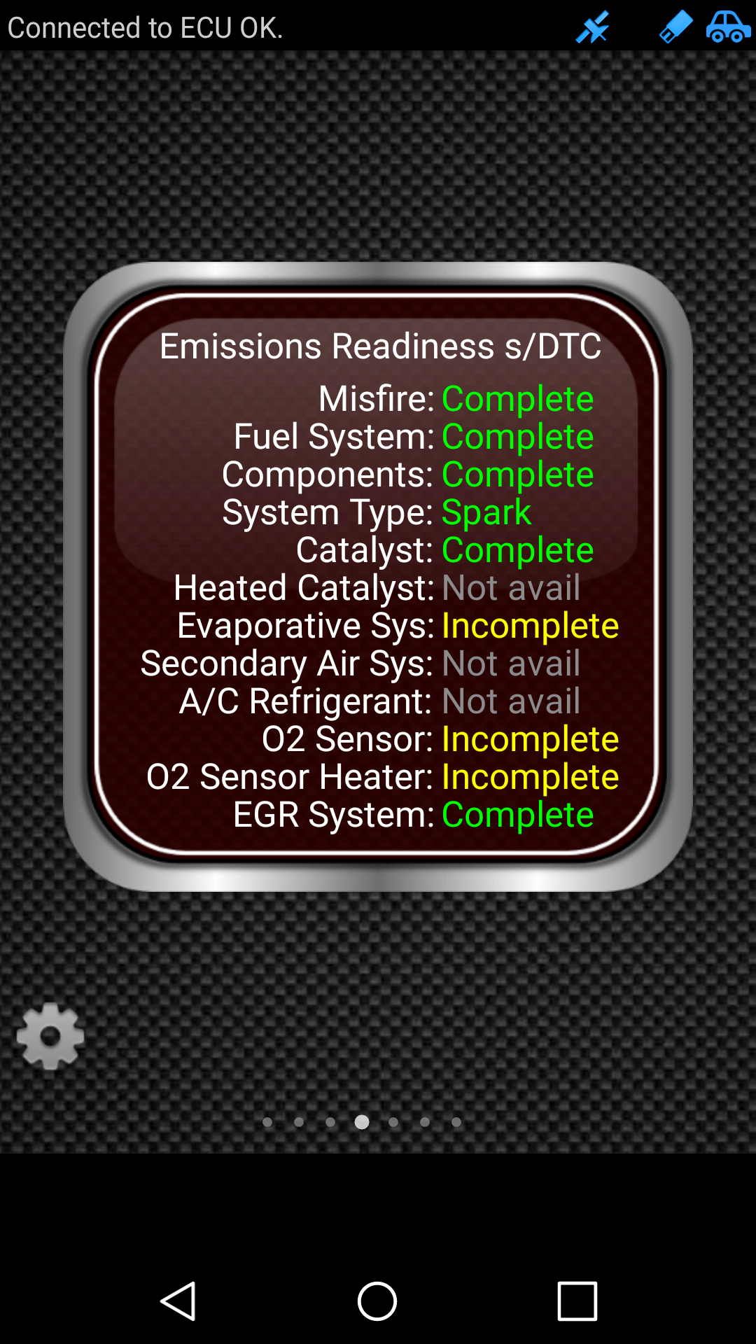

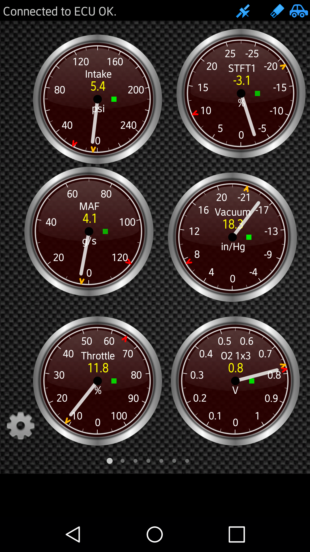

Replaced Bank 1 Sensor 3 with Denso part number mentioned above.
After replacing the o2 sensor
After driving for approximately 10 miles
Bottom right is the Bank 1 sensor 3 data

I've seen on YouTube testing the ohm readings for the sensor to work on a multimeter, and they always say the two black cables. In common Jaguar fashion, there's four different colors (at least under my X351).
Lowest ohm resistance (200 or 400)
Touch white & red wires, and you should get a reading of 3-14 (Source: ChatGPT).
Testing Bank 1 Sensor 3, (CEL P0042) gave me an ohm resistance of 1-2, then eventually fluctuating to 15 for a split second, whereas testing Bank 2 Sensor 3 was 2.6 and stable.
Location wise, the plugs are behind a small metal plate located in the rear of the transmission.
