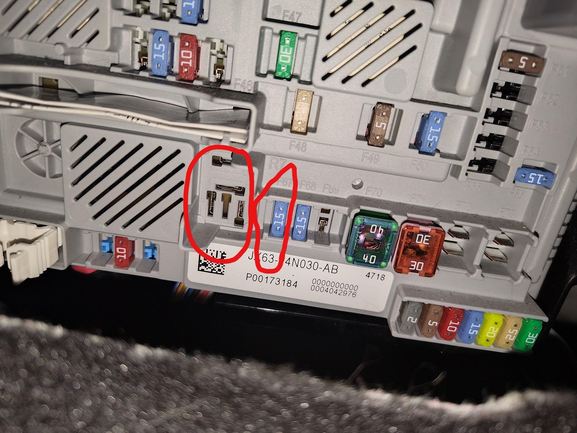

As the title says no trailer lights are working on my X260 Sportbrake. I has not been working since I bought it, perhaps has it never worked. Is R7 needed for the trailer lights, it is missing in my car. I have no voltage on F67, which is strange, but I don't know what it is connected to. I am grateful for all tips!
