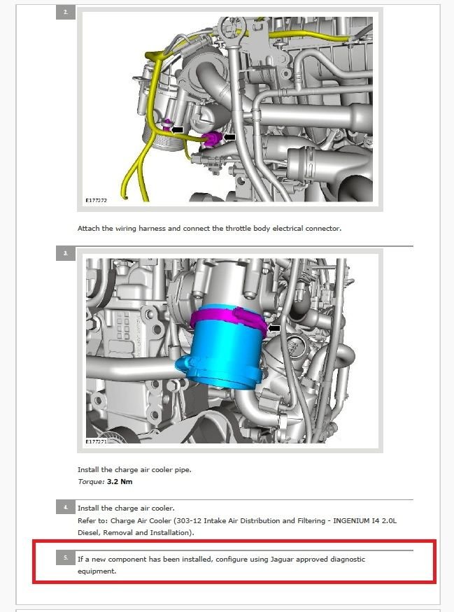

My immediate thought was NO as I've replaced several TB's on earlier models without any configuration being required. However, it never pays to make assumptions with a Jaguar so I checked the X260 Workshop Manual. Looks like bad news:
That being said, JLR insist a BCM must be reconfigured after a battery change and that's not strictly necessary so you could be lucky and find the TB is similarly "plug and pray" as you so delightfully phrased it.
