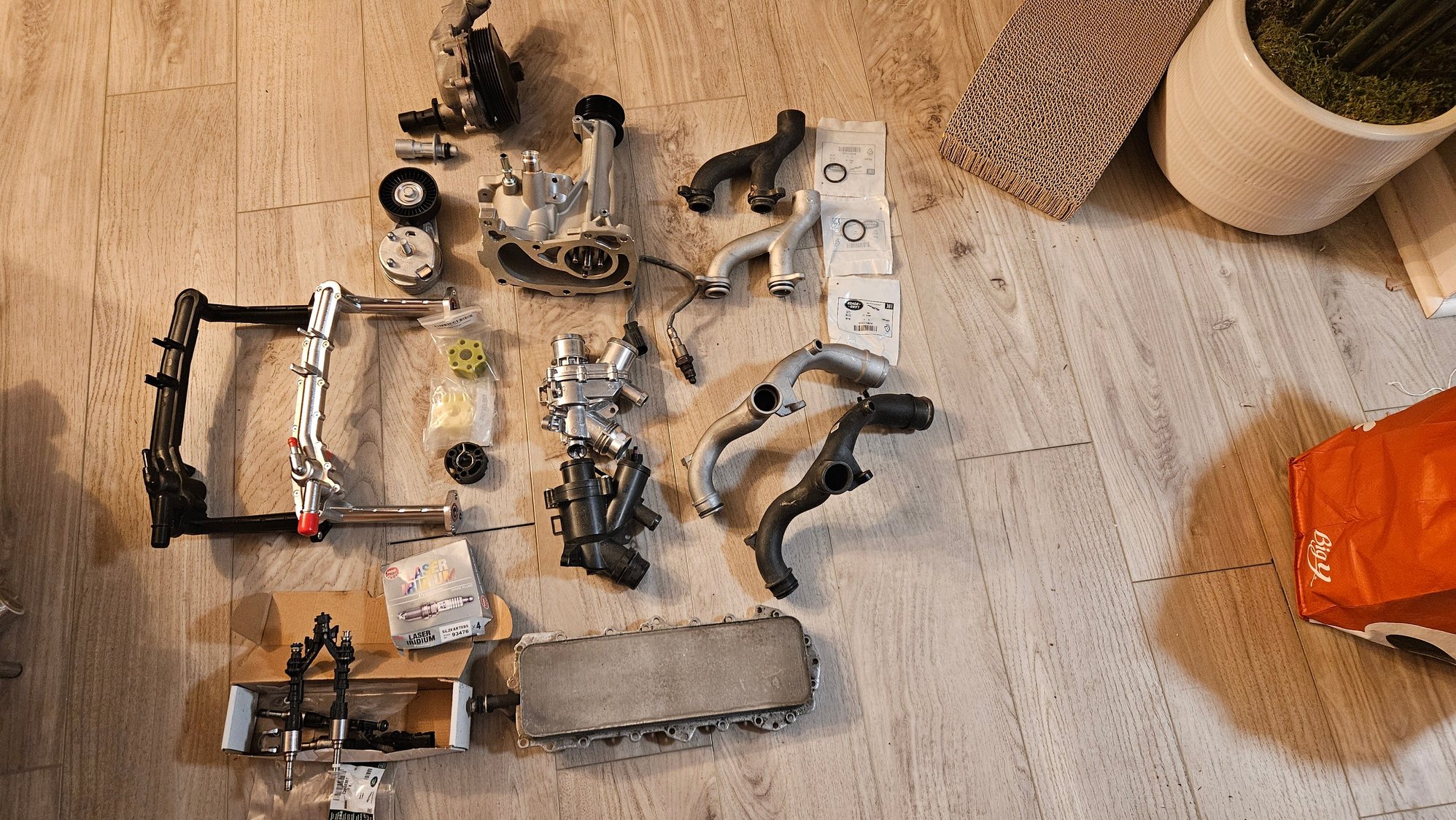

Here is another coolant leak saga.
Mine is Jaguar XE S, with 6 cyl: Had coolant leaking for some time (small leak, but had to add coolant for each week).
1. Purchased the car from Georgia, it was shipped to me in Mass.
2. Went to Jaguar dealer in Sudbury MA to do oil change - they saw some spots - seemed to be coolant colour, perhaps old. Instead of pressure testing, they said "drive around, see what happens"..
3. Read your posts about AMP repelacements, and bought the whole kit on ebay. Found independent shop that was interested to replace the whole cooling system with metal pipes from AMP. By this time, about six weeks of buying parts, scheduling...all the pipes were, it seemed replaced. Then continued loosing coolant. Went back to indie shop, they found another plastic pipe that was not replaced (got it from the dealer for about $100, it was the pipe that is shown in large pictures above, runs at the top of the engine, visible just by opening the hood), it was replaced by Indie shop. Car runs well.
4. Overall cost of buying and installing, total, about $1200. (OF course dealers would charge at least double, some people say it would be triple of that).
AMP certainly did a great job with their offer, only wish they would include all the pipes that need to be replaced after 50k miles (mine was 70k).

Here's a full metal setup lasted 3 years on cars I've done ,watch the Video to help on ideas on how each component is installed

Thanks for the pictures, it looks excellent. I have purchased a total AMP set (similar to your pictures). Works really well, thank you AMP.
In addition, my Indie shop advised me, and we have installed all the hoses leading to the radiator.
And there was one more black line, seen clearly as you open the hood - snaking at the top and then going down to the throttle area.
It was not a part of the AMP set, so I got it from JLR dealer (about $100).
