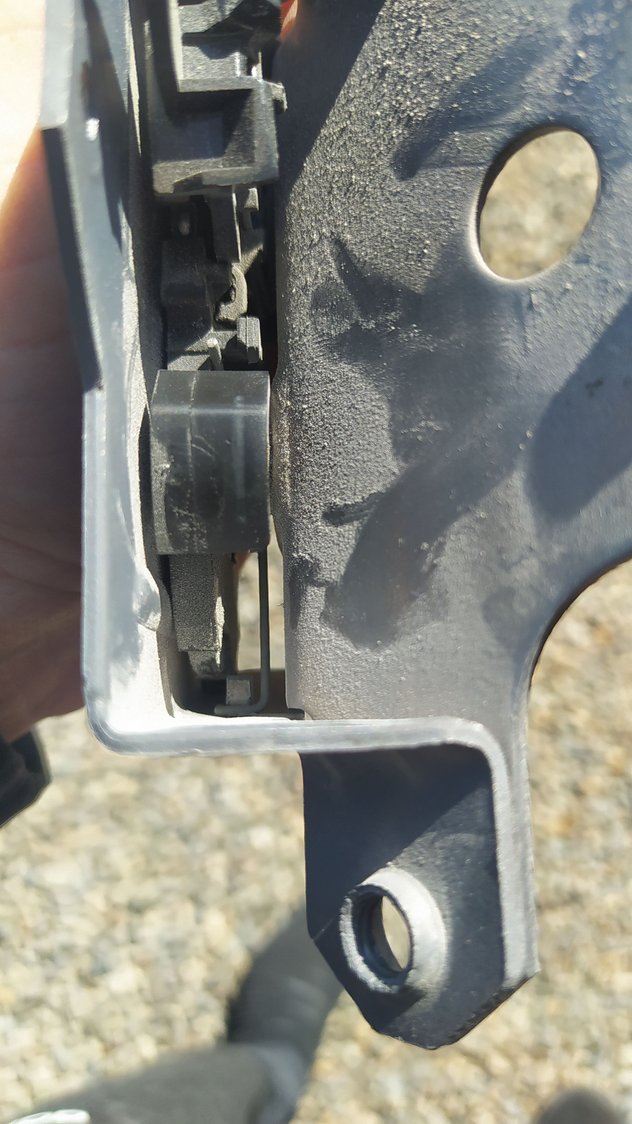

I had a similar situation where the boot wouldn't close it kept opening constantly.
So i took things apart i found that there's a small switch that gets worn down by rubbing against the lock mechanism.
I added a drop of glue on top of the switch, a temporary fix until i got a new lock mechanism.
You can see the rubbing mark.
