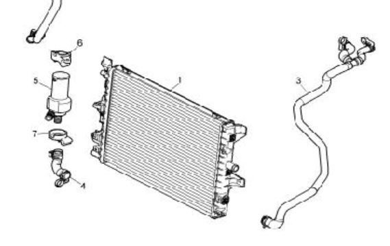

Here is where the IC pump is and it's a long way from the bottom of the car. It's at the top left hand corner of the radiator if your standing in front of the car. Plus the hoses are a very tight fit as there is little room to work. Even WITH the bumper removed.
I have changed several and again please have them remove the front bumper to get proper access. It's really needed.
