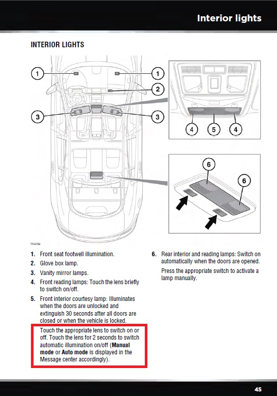

I know this is a stupid one but how do I get my interior light to come on when the door opens. I must have turned them off somehow. I have just turned them an and left them on and the next time I unlock the door they come on but when I get in the car I have to manually turn them off.
Old Mar 3, 2014 | 01:08 PM
It sounds like you need to reset Auto/Manual mode:

I will try this again...thank you

I found with mine that 2 seconds wasn't long enough, it was more like 3 to 4 seconds.
