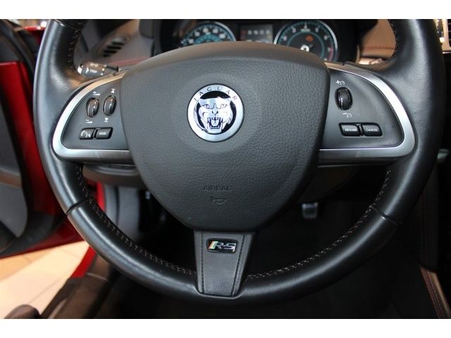

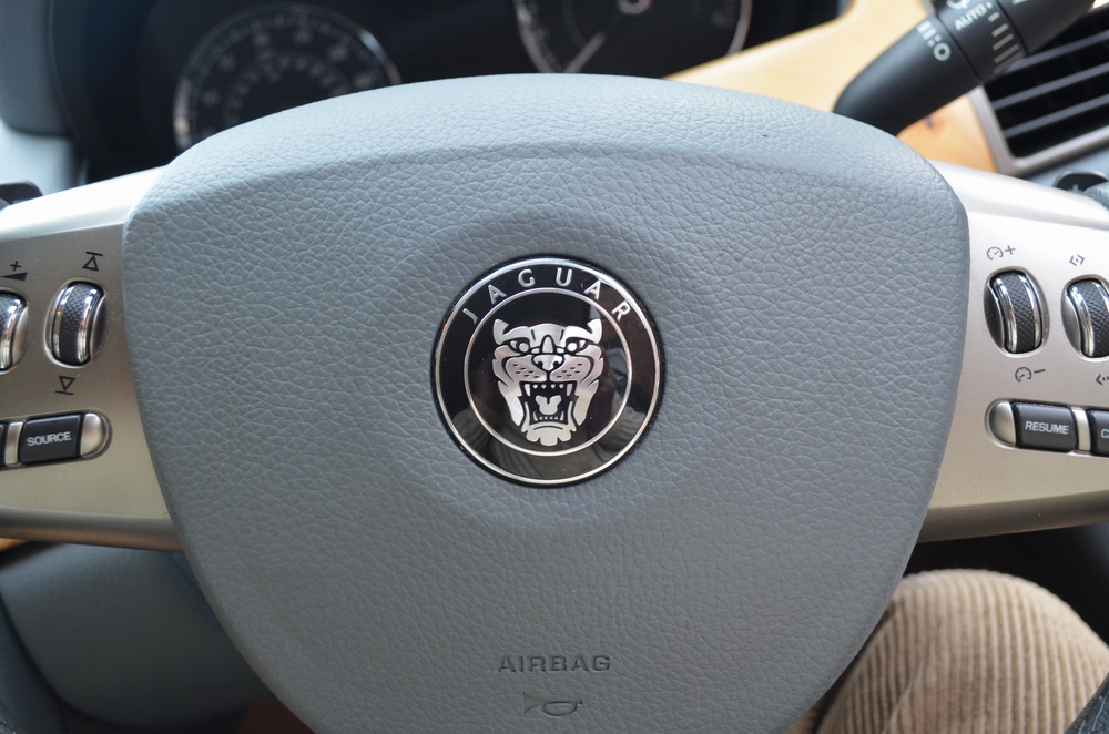

Jaguar Forums - Jaguar Enthusiasts Forum - View Profile: Mike@Jaguar
here is his homepage. I sent him a PM already. The more the merrier....
Attached Thumbnails Dented decal on airbag - XF-%24-kgrhqr-lqfh327fv1qbr-k6kmtbq%7E%7E_4.jpg   Dented decal on airbag - XF-%24t2ec16jhjgeffm088j-vbr-k6ndflw%7E%7E_4.jpg
