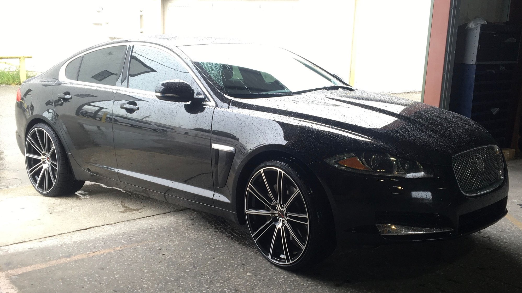

I have 22” rims front 255/30/22 rear 295/25/22

Amazing!!! Do you remember the offset of your rims? Or the brand,/model?

https://gwgwheels.com/shop/index.php...ined-rims.html
