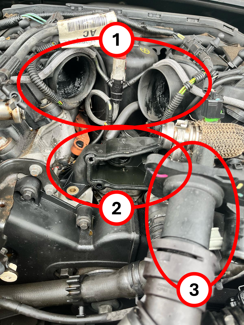

OK, with a little help from a tutorial video I have gotten this far.
I have three questions.
  1. These look incredibly 'gunky' - do I need to clean them or is that normal fora 117k car?
  2. I can't even shift this and don't want to risk breaking anything further - brute strength or is there a technique?
  3. Again, this bit won't slip off - any tips without breaking anything
Then it's just ordering the part, putting it back together and refilling it - avoiding airlocks (I will ask more about this at the time, I'm sure!)

Update – Job Done (Thermostat Housing Replacement + DSC/Restricted Performance)
Quick update for those following along — and thanks again to everyone who offered advice!
Thermostat housing successfully replaced (went with an aluminium version)
Coolant topped up and seems to be holding well after idling for 10+ minutes
Hard reset via battery disconnect cleared the “DSC Not Available” and “Restricted Performance” messages — no OBD tool needed
I haven’t taken it for a proper drive yet, but everything’s looking good so far.
Only slight thing I’ve noticed is the exhaust looks a bit “whiter” than usual, but I suspect that’s just condensation or me being a bit paranoid after working on the cooling system. No super sweet smell, no misfires, and coolant level looks stable for now – so I’ll keep an eye on it over the next few runs.
