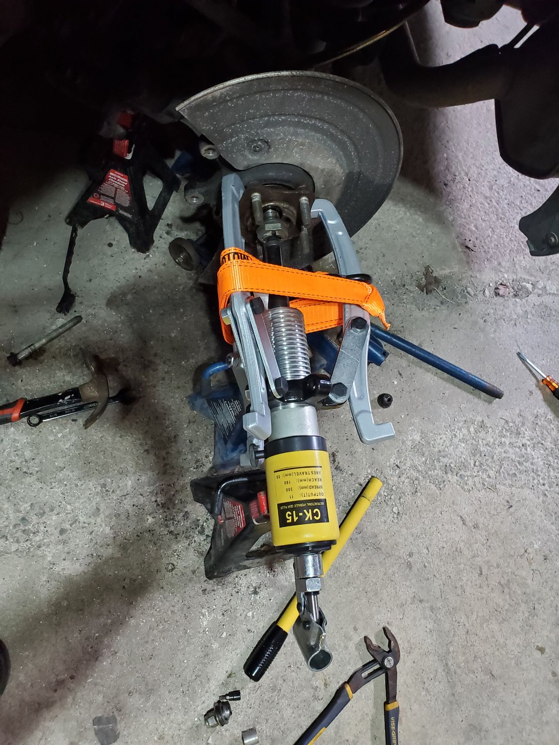

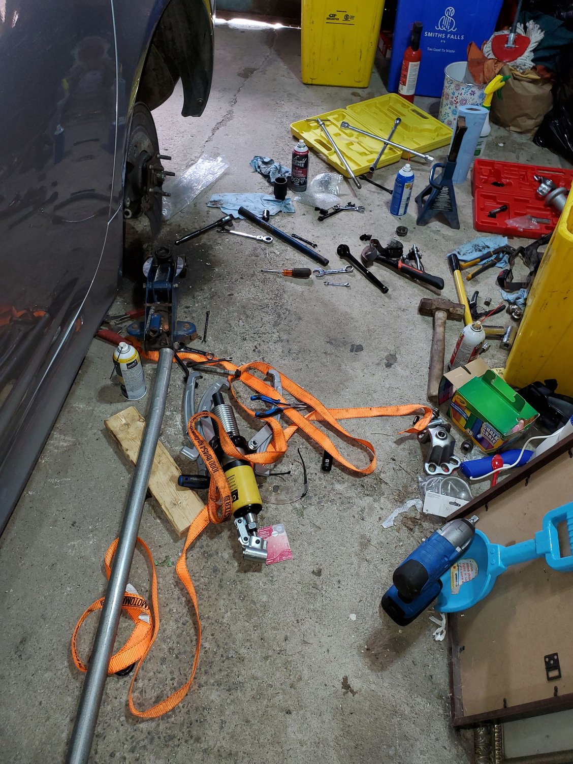

So an update to this thread and my 2011 Jaguar XFR that is looking for a human sacrifice for this wheel bearing..
Broke more ratchets, and more pullers. Ordered a 15 ton hydraulic and it didn't move it.
Changed plans to remove the entire knuckle with the half shaft and take it somewhere to have it pressed out.

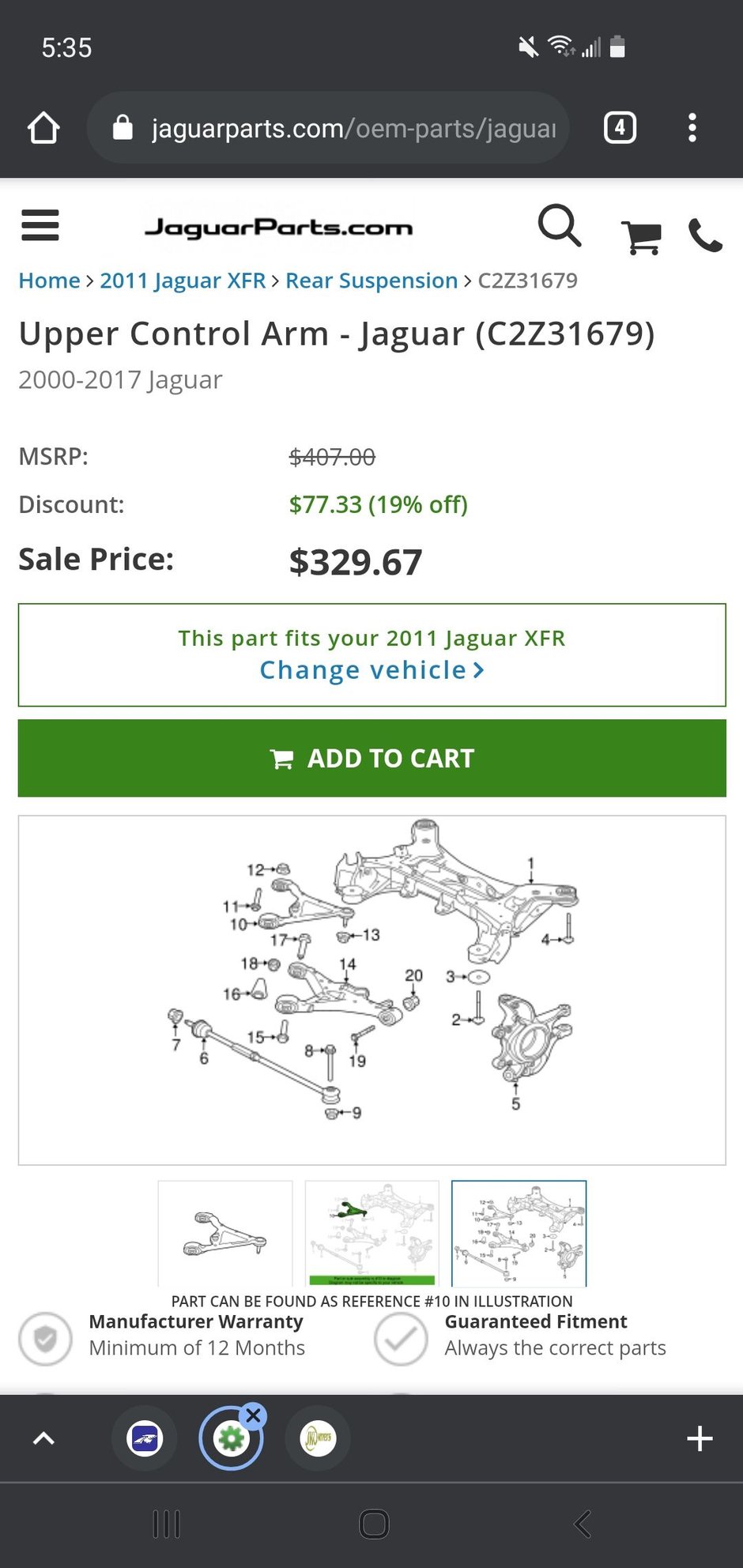

My issue now however is that it looks like I will need to cut the left top control arm nut off the ball joint, image attached shows it as number 13 for a replacement nut, does anyone have a part number by chance for it?
The workshop manual advises for a new oil seal for the half axle as well. Is this mandatory (such as the axle nut) or just a best practice?

I had the same problem with right rear hub .I soaked it in wd for three days using hub puller in your photo but i used impact gun and 5 lb sledge hammer tightening puller hitting with sledge and retightening ,took a while but i got it off and cleaned everything up and installed new bearing with no more problems .Patience is a key when working on rusted parts
