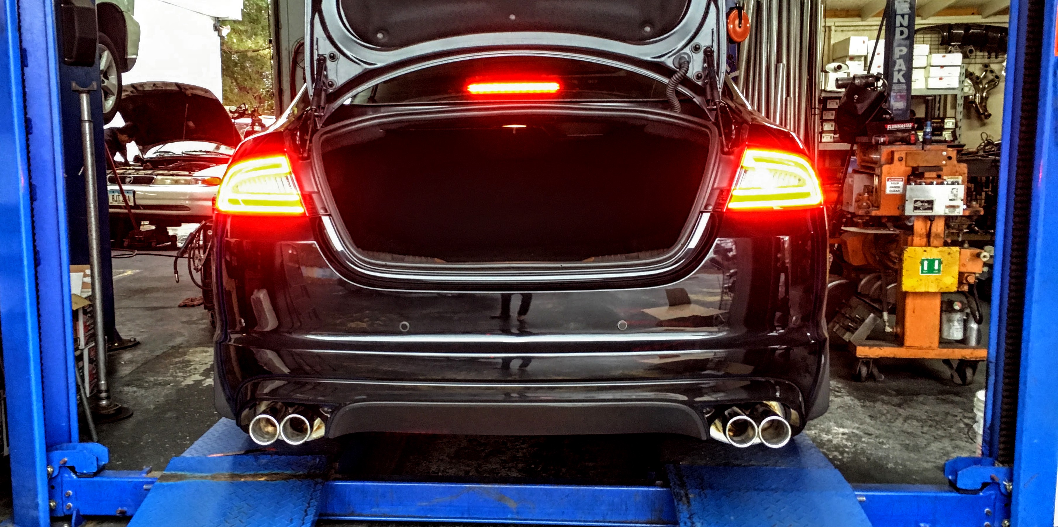

Default Update - Exhaust is installed!
Hello folks, the exhaust is now up on the car. Allen did really good work and I am happy with the results and cost. The exhaust turned out to be exactly what I had hoped for! With the butterfly valve closed, it's as quiet (if not quieter) than stock, no drone at all. With the valve open, it's loud, sounds amazing, and as expected, has drone.
Issues we ran into with the install:
1. I could not reuse the stock clamps as they were welded to the stock mufflers. I could have used aftermarket clamps to fit the new piping, but i decided to weld them instead so I don't have to deal with leaks. This means I would need to go back to the muffler shop to put the stock mufflers back on, but no big deal for me.
2. The drivers side rear has a tow hook near the exhaust tips. This made it difficult to center the dual tips, so we went ahead and removed the tow hook.
Wires routing:
1. I was able to run the wires behind the diffuser and connect both the mufflers to the VK02 cable.
2. Behind the diffuser there is a hole with a plug. I ran the wires through this into the trunk. Unfortunately I didn't take pictures here, but it's pretty straightforward. Remove the 4 screws underneath the diffuser, pull back the diffuser and you will see the plug.
3. I currently have the Varex unit plugged into the battery to 12v adapter. Once my fuse tap kit comes in, I will tap the wires into the fuse box.
Only have pictures at the moment, I will post some videos once it stops raining.
Attached Thumbnails 2012 Jaguar XF 5.0 NA - Varex Active Exhaust Install-img_0894.jpg   2012 Jaguar XF 5.0 NA - Varex Active Exhaust Install-img_0895.jpg   2012 Jaguar XF 5.0 NA - Varex Active Exhaust Install-img_0898.jpg   2012 Jaguar XF 5.0 NA - Varex Active Exhaust Install-img_0900.jpg   2012 Jaguar XF 5.0 NA - Varex Active Exhaust Install-img_0902.jpg
