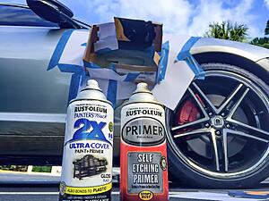

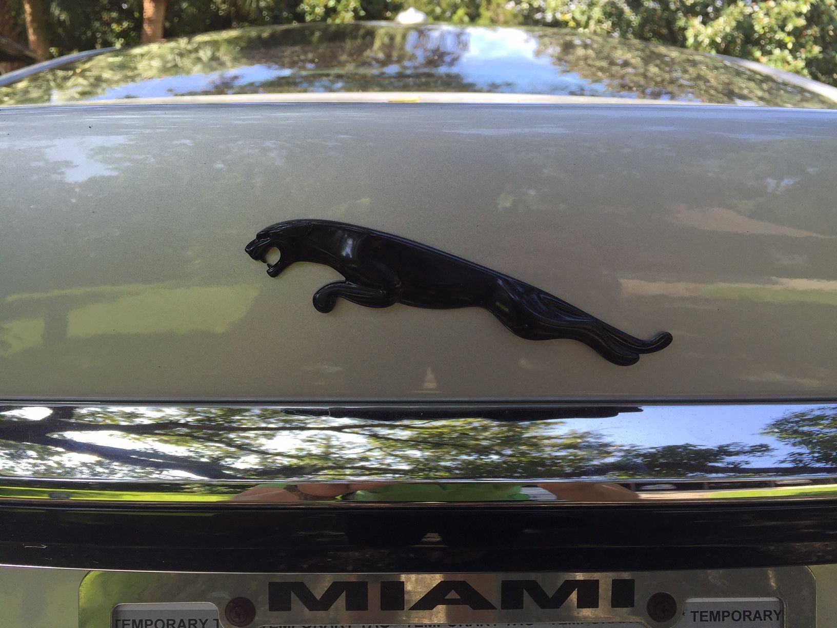

A quick tip for anyone considering buying the black leaper badges for their trunk/boot:
I purchased a "14 cm Black Leopard Emblem Rear Trunk Sticker".
Inexpensive and from China but not everything is complete junk from my experience. The problem, however, is completely flat on the back side so it does not lay flush on the curved trunk. Try to force or bend it and it will snap
I've ended up just painting the one that I removed and that's what I should have done the first time around, you get to keep the Jaguar quality this way.
  1. Use a few strips of painter's tape to mark where the badge is before removing it by lining them around the exterior of the badge
  2. Dental floss back and forth in a sawing motion to remove trunk badge (leaper)
  3. Goo Gone, microfiber towel, and thumbnail to remove stickiness left behind
  4. Clean part with dish soap, dry, with rubbing rubbing alcohol, dry again.
  5. 3 coats of self-etching primer
  6. 3 coats of gloss black
  7. let it bake under an infrared light overnight
  8. cut double sided tap into pieces to accurately fill as much space as possible on back of badge
  9. re-apply

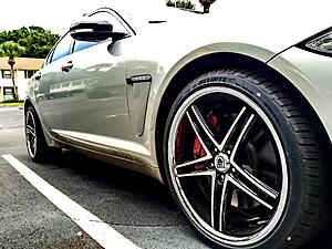

New shoes installed!
I'm painting the calipers tonight as soon as I get off work.
Stay tuned...

I was pretty busy today. I painted the calipers red and painted the chrome things on the side vents in gloss black:
I haven't had a chance to wash her yet because the paints are still curing so please excuse the dirt:

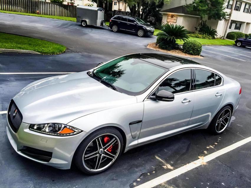

Wrapped the roof in 3M gloss black vinyl today

I have a red caliper paint kit. Will do mine soon/ at some point.
The black roof wrap looks great. Did you do it yourself or have someone do it??
