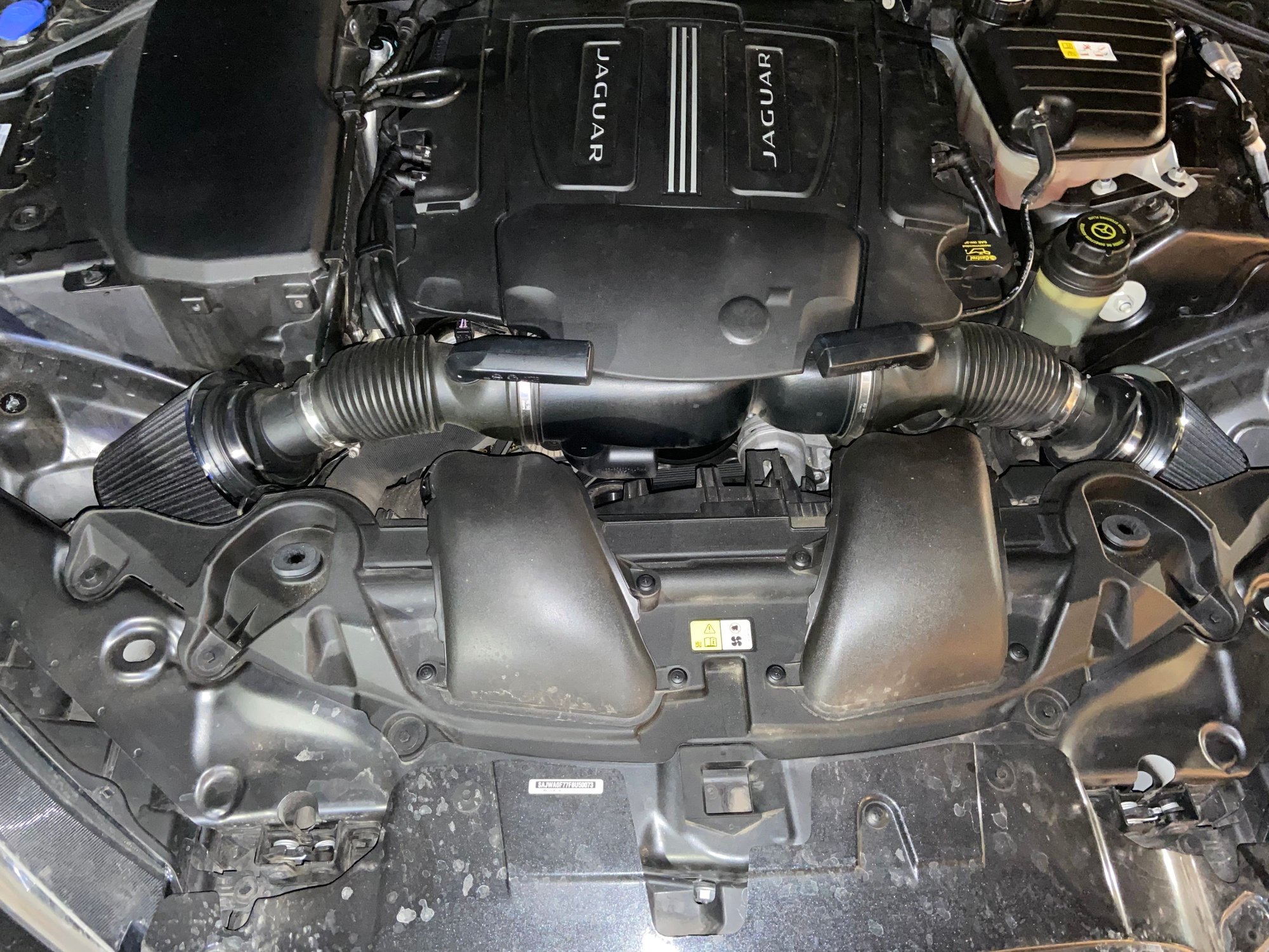

Overall picture

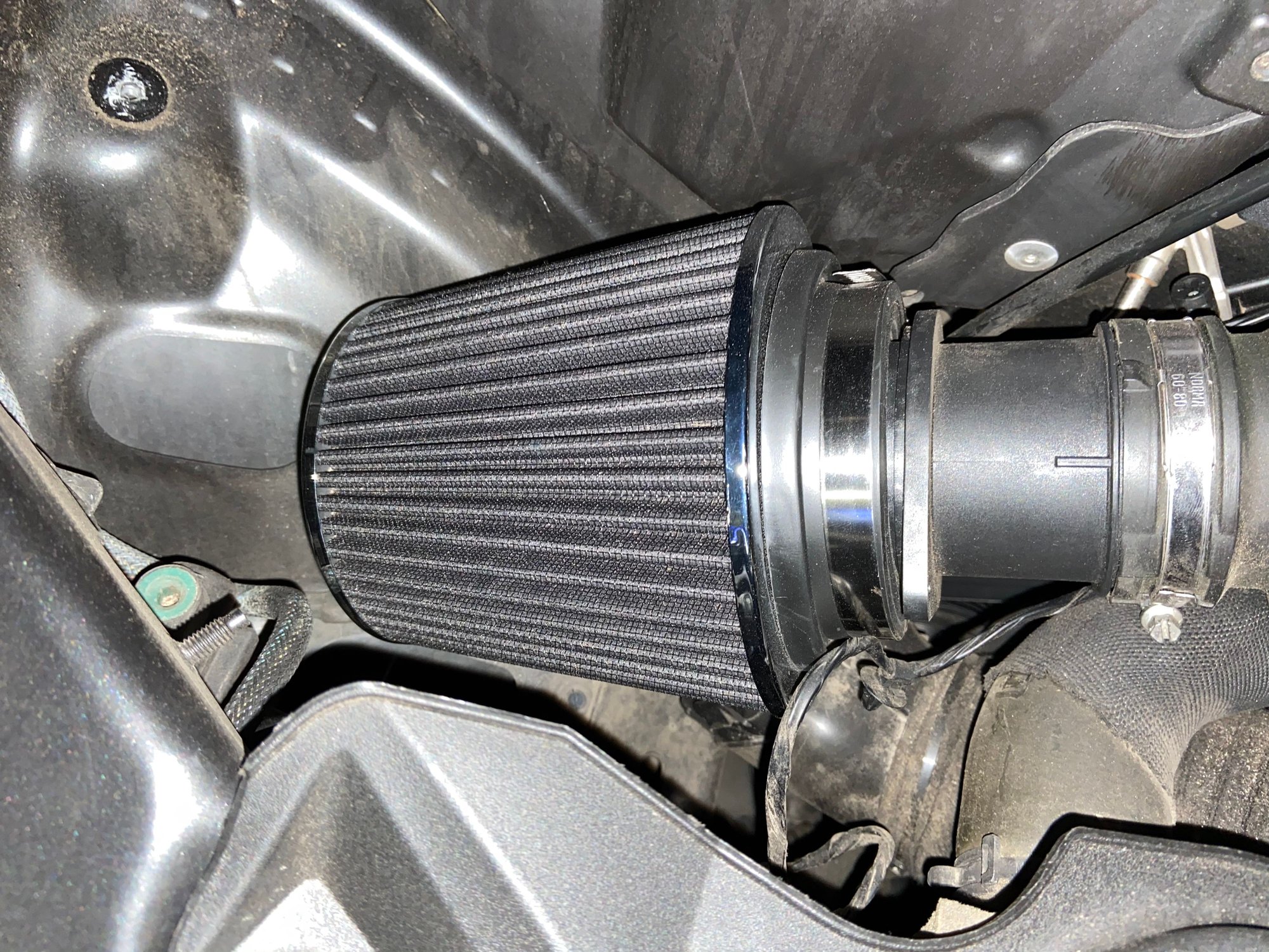

Cone filter attached to factory MAF

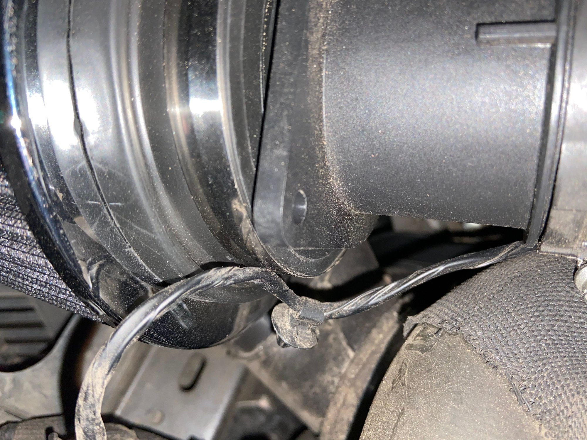

I plan to use the eyelets where the MAF tubes connected to the factory air box to rig up support.

I'm going to do something similar but keep the cones in the boxes so I don't get heat soak,looks good
