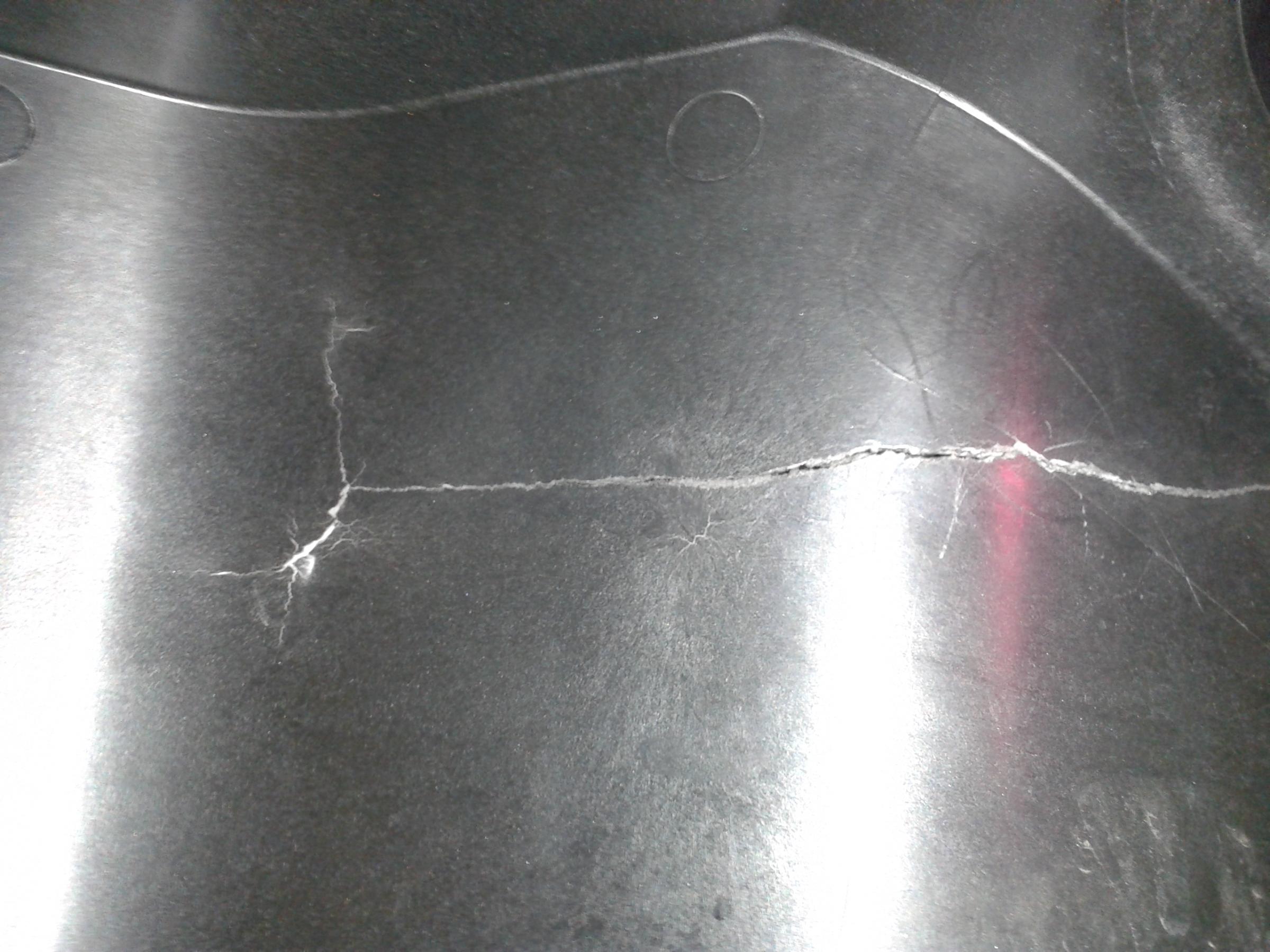

Well after going away and fitting two new maf sensors and still getting engine light on, went and done another inspection. Low and behold found this, a crack in the passanger air box. It is located right below where the inlet pipe begins, as you can see from one of the pictures the mesh protecting the sensor can be seen. Car did get a previous small bang low down on that side which i was aware of, non structural , which must have done the damage. I got an air line and put in up against the crack and the air is blasting through. The Maf sensor during live data was showing fluctuations in reading compared to the other side. Dealer is ordering a new air box so hopefully this is the end of it
Is the thought process here that additional air is being introduced into the airbox up stream from the filter and then changing the sensor reading causing a MIL? This would make the sensor very sensitive . Also putting compressed air to the crack would show more of a leak vs just plain air under driving conditions. I hope this is the fix but I am a little skeptical at this point. Good luck.

jagtoes, i hope this is the problem. The other side is perfect, 2 new sensors and 2 new jaguar dealer filters. the OK side shows good readings during the live data. The crack being before it hits the sensor would be letting in more air or out. As i said the side with the crack seems erratic. I'm presuming when i accelerate the car takes in air some is either coming in through the crack or pushed out, hence the readings. All i can do is try it, anyway i would say that the crack isn't doing any good for air intake.

Some of the old tricks still apply.
You can watch the short term fuel trims and spray a little MAF cleaner on the cracked area. If air is leaking in, you will see the trims go crazy.
It is a good find, fingers crossed that your problem is solved.

It is unlikely that a small-ish air leak will cause any permenantly damage. If you can monitor the short term fuel trims just check that they aren't pegged at +/- 25%. If you see them somewhere in the middle, then the car is able to adapt to the extra air and no big deal.
I'd wager your idle problem is that the leak is a larger portion of the total air the engine is consuming at low rpm and load. Once you get moving the leak is washed out by the larger overall airflow so the car runs fine at speed.

I have usually found that a "hunting" idle in the range that the OP has stated is indicative of an air /vacuum leak in the intake system. This would fool the sensors and change the idle. The basic function of the MAF is to work with the 02 sensors and ECU to adjust pulses of the injectors to attain the optimum fuel/air ratio. At least that is the short definition. I would think the MAF could adjust for the crack in the intake box without setting a code. Did they try a smoke test to see if there are any leaks in the emission system.

yes exhaust system is ok no leaks, did as i say put tape on outside of air box and after erasing light it has not come back on yet, so will have to see. rough idle is only when starting and sometimes when i come to an abrupt stop, but not all the time .
