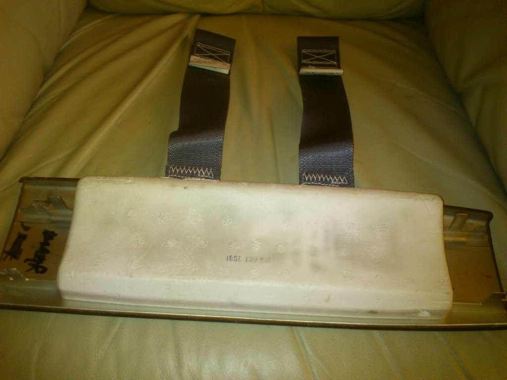

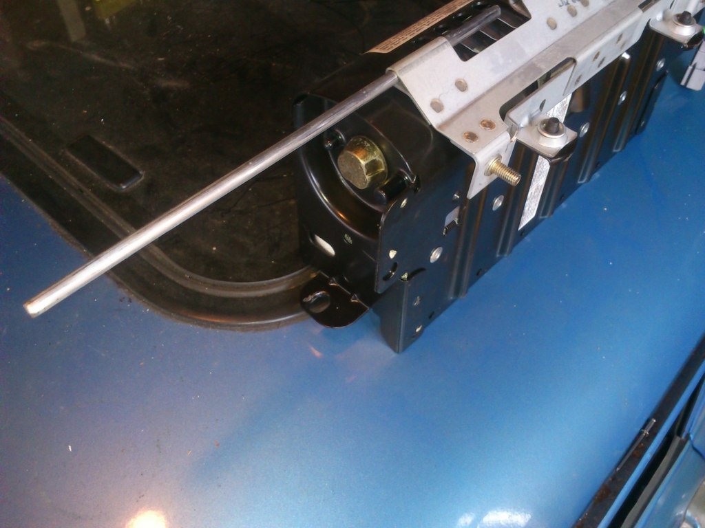

Removing the veneer over the airbag isn't a problem. I've just done it on my XJ8 (near identical arrangement). Undo 4 bolts inside the glovebox - 2 in the roof at the front, and 2 at the back. Glovebox + veneer drops out. The veneer is a push fit into the airbag frame and is held by two straps (seatbelt webbing) which is located by a long pin which slides out (with assistance!) Look at the pics.
However, before you do anything you MUST disconnect the battery and touch the two cables together. After dropping the glovebox sit to one side and pull the plug (to the airbag) out in one jerk. The contacts are recessed but tape over them as your own static could trigger the detonator! (Set that off and you will be deaf for a day and you'll have to pay someone A LOT of money to clean the seat!)
When re-installing leave the battery disconnected and short the plug terminals (from the car loom) to earth before plugging the socket back together (sitting to one side again).

The Airbag assy showing the sliding pin

The veneer with straps
The back of the veneer.
Old Aug 30, 2015 | 08:48 AM
jimforrest (uk)'s Avatar
Joined: Feb 2015
Posts: 292
Likes: 125
From: Hampshire
Oh - last pic didn't show -------->
