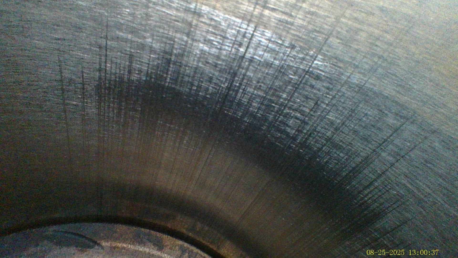

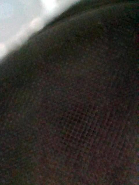

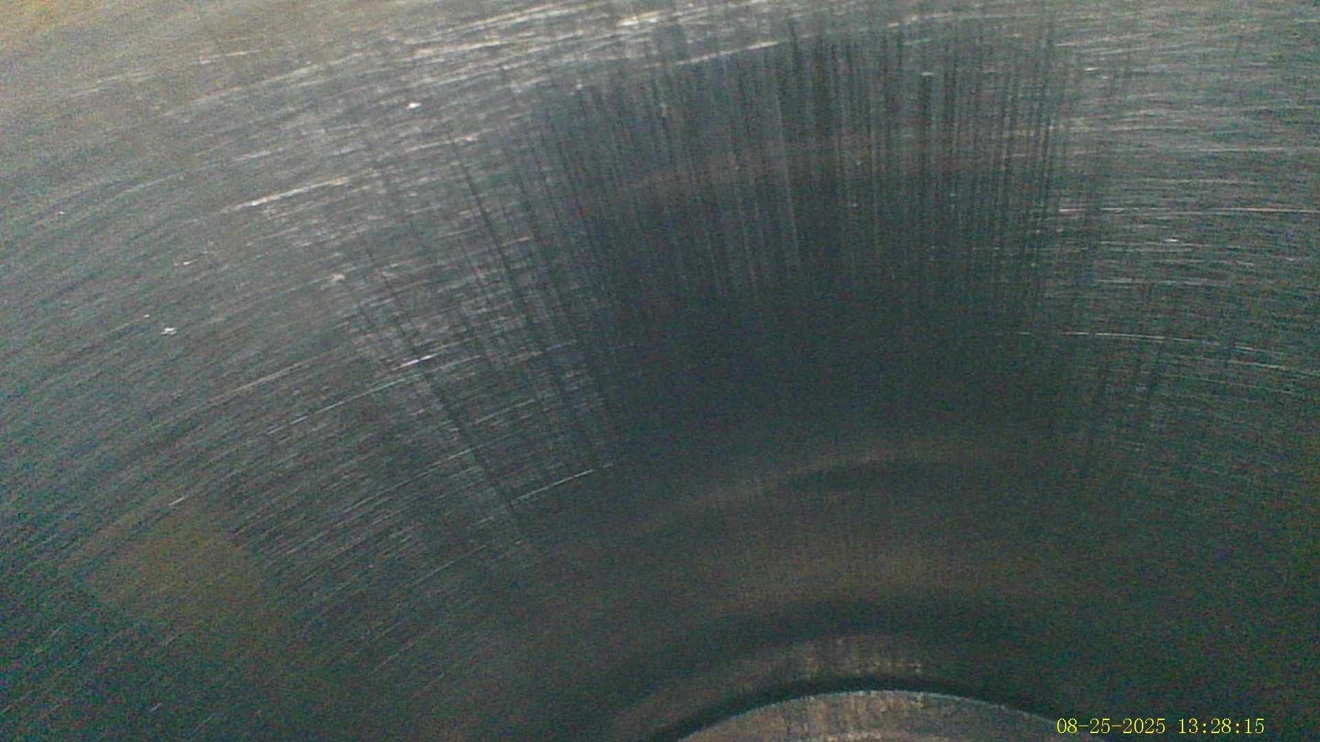

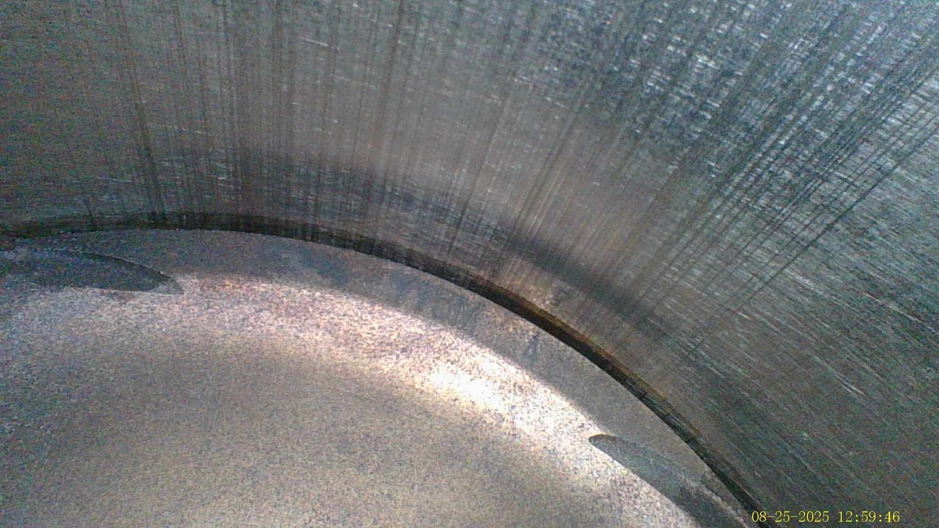

Thanks everyone for your replies.

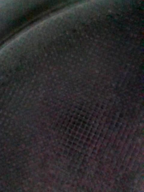

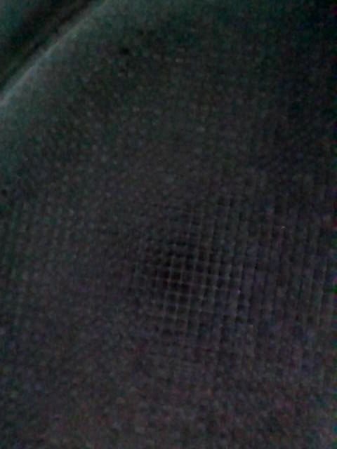

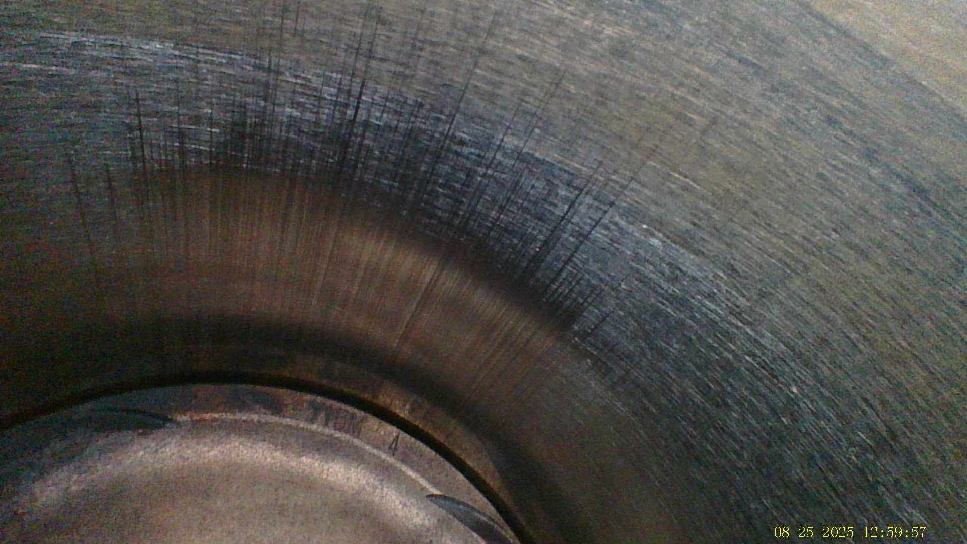

Here are the pictures of the cylinder walls. I’m pretty sure these scratches shouldn’t be there. Is this considered normal wear, or does it mean the engine is done?
Cylinder 1, which never misfires, looks about the same as cylinder 5. I checked other cylinders and they looks similar too.
Cyl 1
Cyl 5
Old Aug 26, 2025 | 01:09 PM
  #28
Vasara's Avatar
Joined: Mar 2020
Posts: 1,133
Likes: 361
From: Finland, Helsinki
Typical lubrication fail. The horisontal honing is lost and that will increase temp of piston and piston ring. (by increased friction)
Lubrication fail can be caused by wrong type of oil, too long oil change intervals, too low oil, coolant wash, fuel wash by leaking injector or issues on ignition system.
All is not lost, but pushing engine hard can cause piston or ring seize. This is still fixable by honing work if the cylinder bore roundness are still in tolerances.
I would recommend to check the coating of piston shirt and replace the rings while in there.
If cylinder roundness exeeds its boring work with oversize pistons.
Old Aug 27, 2025 | 08:14 AM
  #29
kansanbrit's Avatar
Joined: Dec 2013
Posts: 978
Likes: 275
From: Kansas
I don't think that is your problem, looks normal wear to me.
Leak down test would have shown up a significant problem.
Piston is very clean, how come ?
Old Aug 27, 2025 | 11:53 AM
  #30
Olek's Avatar
Joined: Jul 2025
Posts: 65
From: VA
The car has 67k miles. There’s some deposit on the pistons, but it’s probably not visible in the photo because of the lighting. All pistons look about the same condition.
I soaked the cylinders with Orval oil and Berryman B-12 Chemtool(1/4), just in case it’s a stuck ring. I’ll check tomorrow to see if there’s any improvement.
Old Aug 27, 2025 | 02:49 PM
  #31
Vasara's Avatar
Joined: Mar 2020
Posts: 1,133
Likes: 361
Absolute not normal wear. At least not at 67t miles. Seen engines over 300t miles (500t km) still having cross hatch honing grooves well present all around cylinder walls.
When honing grooves is lost there are no pockets for oil to stay and keep parts separated.

You are entitled to your opinion. They all look very shallow marks to me. You really think there is enough 'damage' to cause misfiring even though the leak down test was good ?

No, the losing the Cross-hatch finish honing do not cause misfiring, also no effect to the leak test at all. Its not for sealing, its for lubrication. In high propablity its one cause generated by the issue itself. Good on this are that this could lead you for the actual fault.
My penny:
* Since you are not loosing coolant and there are no exhaust remains on coolant - Coolant wash can be ruled out.
* I do think that you have been changed the oils and used good quality oils, so in high propality we can rule engine oil out as well.
I put my bet on fuel wash:
- Maybe your ignition don´t ignite the mixture every time : Spark plugs / coils. OEM? (counterfeights in market)
- Maybe your injectors leak or make droplets? (forget the correct english term) Again: LOT of counterfeights
- Sticking or leaking valves, lifters or rings? Low combustion pressure make poor burning and unburned fuel wash the cylinder liner everytime piston goes back up after "bang" cycle. (hardest to find, but if moving coils, sparks, injectors around and issue stays on same cylinders, then this is something what is left...)
I have done "few" engines myself (for racing) and blown up as many for my own mistages or just .. Well, we call it Motorsport when everything goes bust and you swore it was last time you do this sh*t, but then next weekend you have tools on your hands again...
After moving coils, sparks and injectors around and if the issue still staying on same cylinder(s) i would suspect something on these cylinders itself.

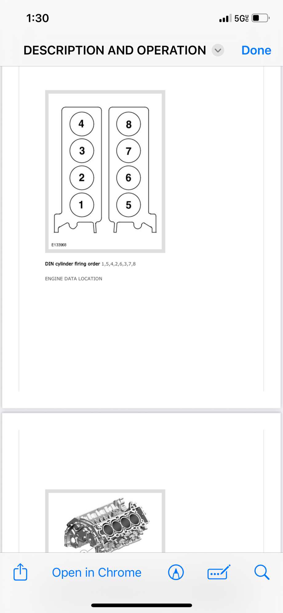

Are you aware of this cylinder numbering?
Old Sep 1, 2025 | 10:49 AM
  #37
gt40's Avatar
Posts: 96
Likes: 34
From: Cape Town, South Africa.
That is a very interesting point. The 2015 Range Rover actually uses the DIN cylinder numbering system and is different to the earlier AJ133 engines which follow ISO numbering. (I think the change happened in 2014).
DIN Numbering
Bank 1 (right hand) is 1,2,3,4.
Bank 2 (left hand) is 5,6,7,8.
So if one is troubleshooting while following the ISO numbering system as quoted by Kansanbrit, the results will be very confusing.

The numbering is clear, confirmed by unplugging coils while checking live data.

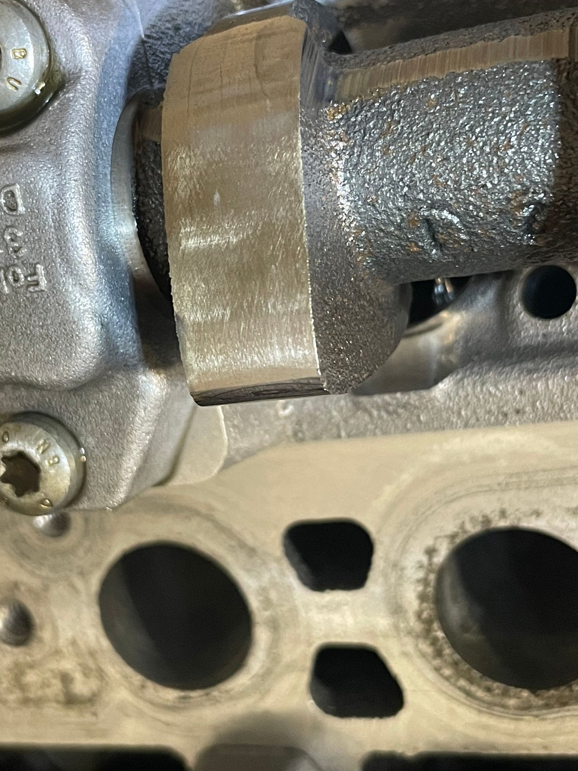

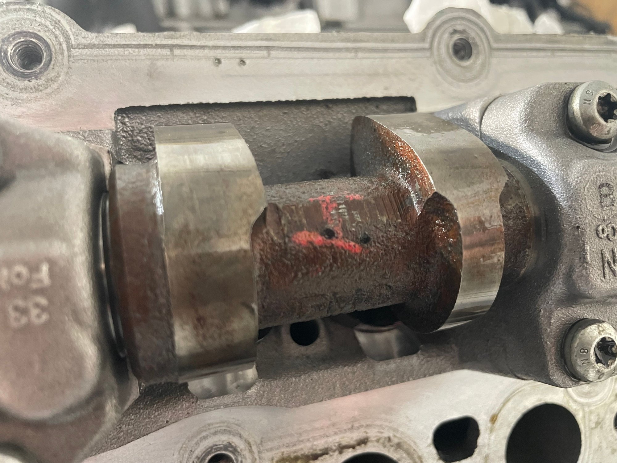

Hi everyone,
Sorry it’s been a while!
I still haven’t given up on the car - it’s become a personal battle at this point 😄
The misfire is still there. I’ve pulled the engine out and plan to do a full rebuild, assuming the block and heads are still in good shape. It’s going to be a long road ahead with disassembly, and I’ll probably start a new thread later once I dive deeper.
Current observations:
  • It’s pretty clear someone’s been in this engine before - a few brackets are missing.
  • There’s one broken bolt on the bank 2 valve cover (not a big deal).
  • More concerning: one of the bolts that secures the supercharger to the head came out with the partially thread still on it. That’s the bolt between cylinders 5 and 6 - the same area where I’m getting the cold-start misfire. Not sure if it’s related yet, but I’ll find out as I tear it down further.
  • Some areas look slightly rusty, not sure if that’s normal.
  • Also noticing some wear marks on the camshaft lobes - could someone please let me know if that’s typical or something to worry about?
  • Lastly, I’m not sure if I need to replace the timing chain. Mine looks to be in pretty good shape, but I’m not sure how to properly check it. I just don’t want to replace it unnecessarily if it was already done by the previous owner.
Rust on camshaft
Rust on camshaft
Please observe the spots on the tip of the lobe
Old Oct 18, 2025 | 11:08 AM
  #40
f-driver's Avatar
Posts: 132
Likes: 67
From: Germany
I think this cam lobe is totally gone. Looks like someone grinded it down with sand paper
for whatever reason.
