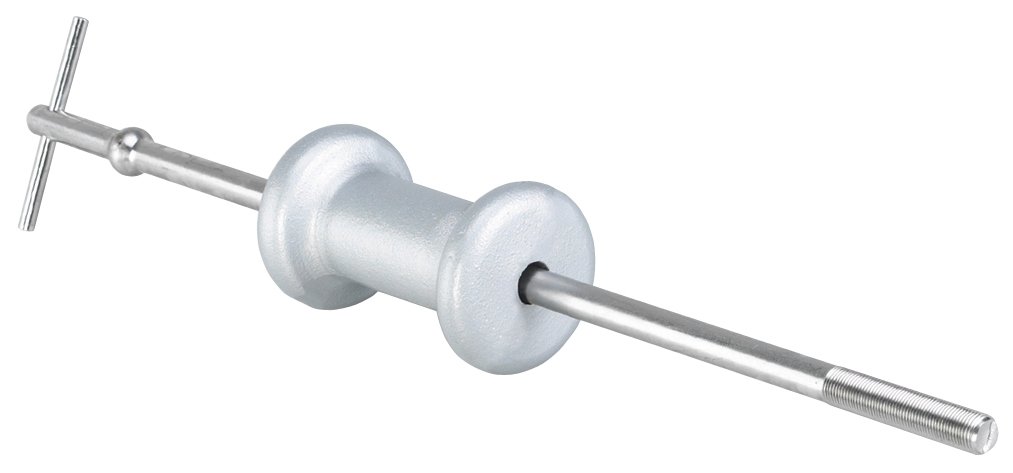

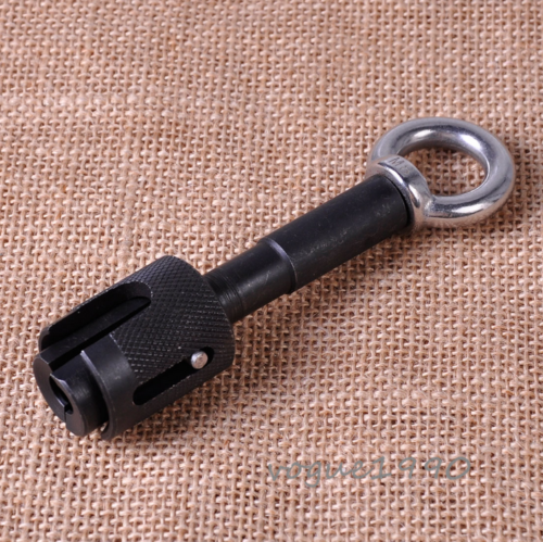

Quote:
The injectors are impossible to remove without a tool,!! Too hard, you need a 🔨 tool,it hooks to the injector then on rod connected is a heavy peice, so it's like hammer in reverse.
the gaskets in jaguar are 2. Layer. And 3 layer, but in the end it goes to one number, and l get the thicker propably.
After trying unsuccessfully pulling the injectors this is my next step.
I got this part and am using a slide hammer which is what I think you are
using too.
I'm glad there's three of us working on the 5 liter engine. We hold responsibility toward our Jag community to share tech info. Dave and you off course have advanced far more than I. Good luck.

  #136
Ya this will work
This Shoukd get injectors out, heading to Afrika for 10 days, will order the timing kit, and head gasket, and honing tools, and assemble engine early March
