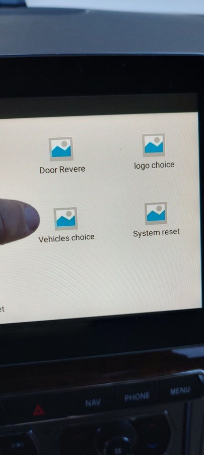

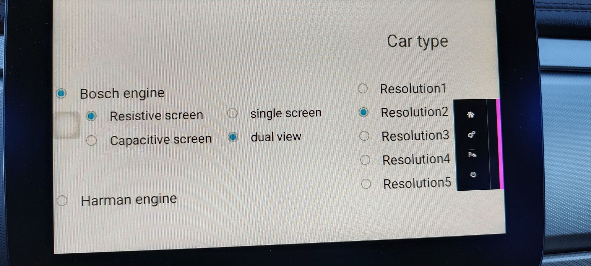

I've just got one of these units but am not having any luck getting the original display to come through. Instead, I get a blank screen. Touch beeps can be heard, so it seems that it is communicating. I can switch back to the Android screen with a long press.
"Karen" from "support" is not being much use at the moment as the only advice I got was to copy this video. Makes no sense to me...
https://mp.weixin.qq.com/s/i7eb7EN8I2yOgqdxV9_hKg
The only difference to @Taffyduck is that my display has a model number of EX23-10E889-CA, whereas his is CX23-14F667-AH.

I had the same trouble, only with mine the board was defective. Check the system settings and see if it's actually listed. If not the board isn't working. If it is there check your factory settings to make sure the correct display is selected.

Thanks @Taffyduck ! I have just spent some time going through all combinations of Car Type and resolution with no success. What did work was setting "dual view", even though I was not aware my car had a dual view screen.

The converter showed up OK from the start, it was the "dual view" setting that was the solution in this case.
