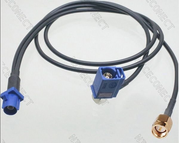

Whilst I'm waiting for a refund, and then replacement, anyone know where I can tap into the factory gps aerial connector and split to the android unit? On the missus Merc it was super easy with a splitter with a diode and appropriate fakra connectors M/F.

You bring up a VERY good question and one I messed up when I did my Android install.
I could not find anyone who could answer that so initially I installed a separate GPS antenna because I was warned that GPS antennas back feed voltage to the head units and simply splitting the signal might cause electrical failures somewhere in the system or it might not work as an antenna if there was too little power.
But later I read on the forum that people were just using a "Y" lead with Fakra connectors to split the signal and they reported no problems using the factory shark fin to feed both the stock and Android units. But no one else reported so it was kind of a one off? He did point me to the Y connector and they are cheap.
Here is what I purchased as there are many Fakra connectors and the colors usually mean something too. I have a 2014 XJR so it may be different from what an XF requires but probably not as things are very similar across the models. It just connects to the GPS lead going into the back of the stock head unit. So no need to access the base of the shark fin. Which is a bitch to do because it's under the headliner and you have drop all that and mess with the Pano glass roof. Something I have so far stayed away from.
It's even cheaper than when I bought mine.
Fakra Y Connector
My only caution is I have not yet installed mine as I have not been motivated enough to tear things apart (again!) to put the "Y" connector in and remove the second GPS antenna I have in the corner of the front windshield.
I like the diode idea and kind of thought that would be a good safety feature but he did not use one and said both navigation systems still worked fine?
If you do install this please post back as I don't like the second antenna and wanted as clean an install as possible.

Thanks for your response, I've been thinking about this situation and bought the exactly same connector myself, however whilst this drama with my jag screen has been going on, I managed to install one in my the missus' MB and I was steered very firmly by their community to a splitter with diode as it causes all sorts of issues on the MB's due to both devices trying to power the GPS module (flickers and screen blackouts). Just for safety sake I am going to get one with a diode to rule out any future issues. This is the one I have on order Z M to ZF90 SMAM90 and will connect the diode blocked part to the android unit.

I think I will order that one as the added diode gives me more confidence. I agree that both navigation systems will be trying to power the antenna (Or take power from the antenna?) and that will or might cause problems. Glad to see another car brand mentioned so nothing special with the Jaguar systems. I hope anyway!
Interesting as I can't find any with Diodes on EBay.
Which length did you order? I got the .5M now but that Aliexpress listing has a 30cm lead which would take less space behind the dash.

Same here, I thought the 30cm would prob be ok, but for safety sake went with the 0.5m too just in case I needed the slack when sliding the unit back in or something like that. I did find one on amazon too though, but IIRC it was £20+ so stuck with cheap alix route.
