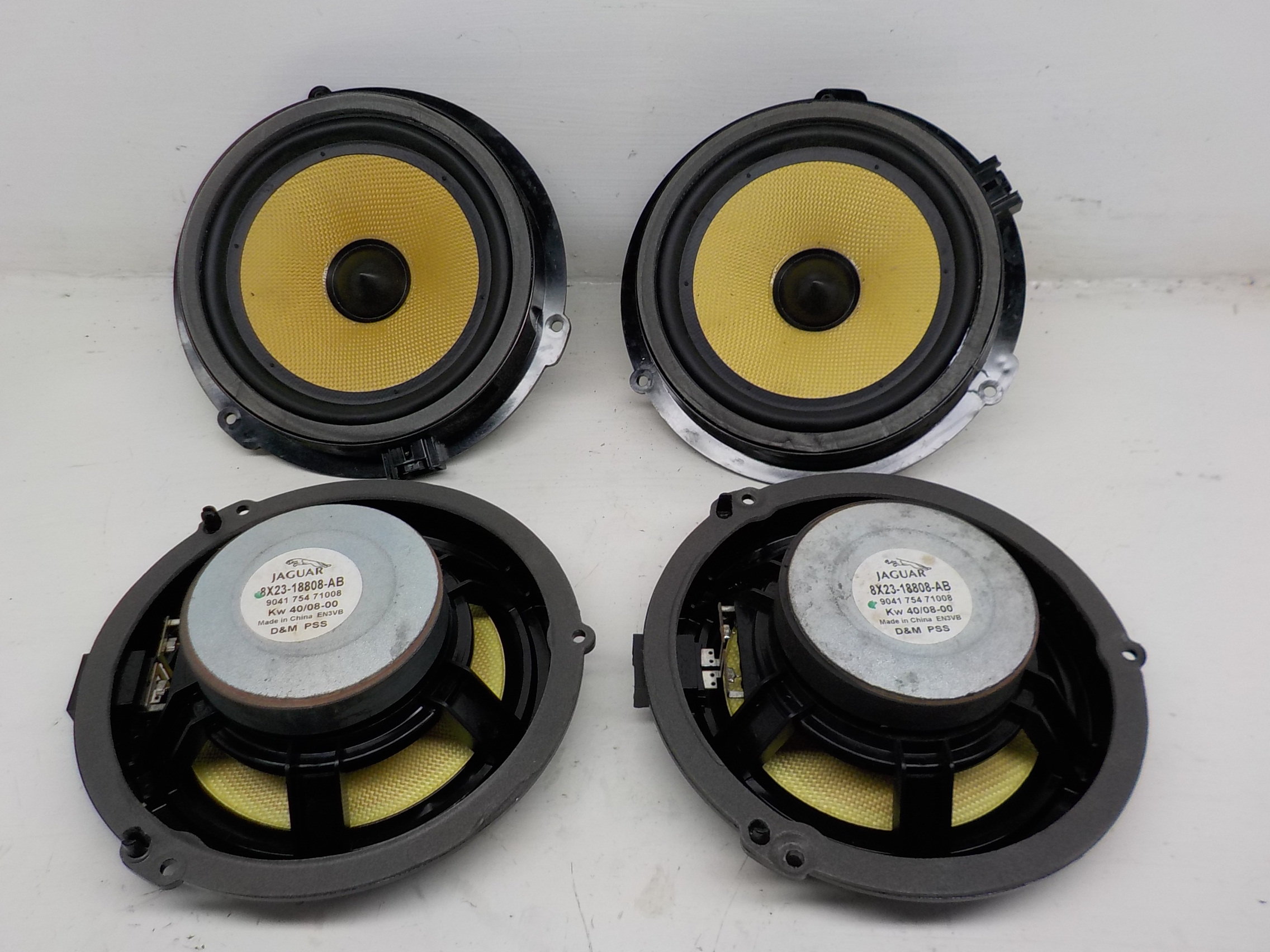

MK2have same bass units, and later MK3 have black kevlar cones but small neodymium magnets –same as Meridansystems . BL issmaller , voice coil is smaler andsound is less powerfull and goes to compression already at20W. its downgrade IMHOI think fromdrivers perspective midwoofers is highest quality comparing to other drivers.

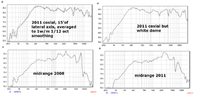

3)MIDRANGES MK1 1 have steel basket, small VC and pastics duscap. MK2 have biggervoice coil, bigger neo magnet ,pressed paper dustap and plastics basket.this is where I have some critcs.MK1 midrange have more peaky top end and I easilycan hear nasty cone break up. MK2 is moresmooth sounding(bigger coil=more inductance, bigger mass= less top octave)butits have basket frame resonanses and I would say those even morepronouncedin level than MK1.in MK1 postprossesing is aplied whenincreasing center channel- frequencies from 5khz is tilted up. probably its to compensatedirectivity.
4) Center channel-MK1 uses same midrange unit, MK2 uses Coxialunits with tweeter aded (see tweeters section)
5) Rear shelfMK1 uses same midrange unit, MK2 uses Coxialunits with tweeter
6) Tweeters .there is hughe technical diferencies in tweeters – Mk1 have more thandouble higher resonnase frequency, much smaller magnet.they sound diferent as well, MK2 tweeterssound more lush and more powerfull- they can be corssed as low as 2khz whilemk1 3.5khz or higher.in rear doorsthis is esential when tweeters work harder

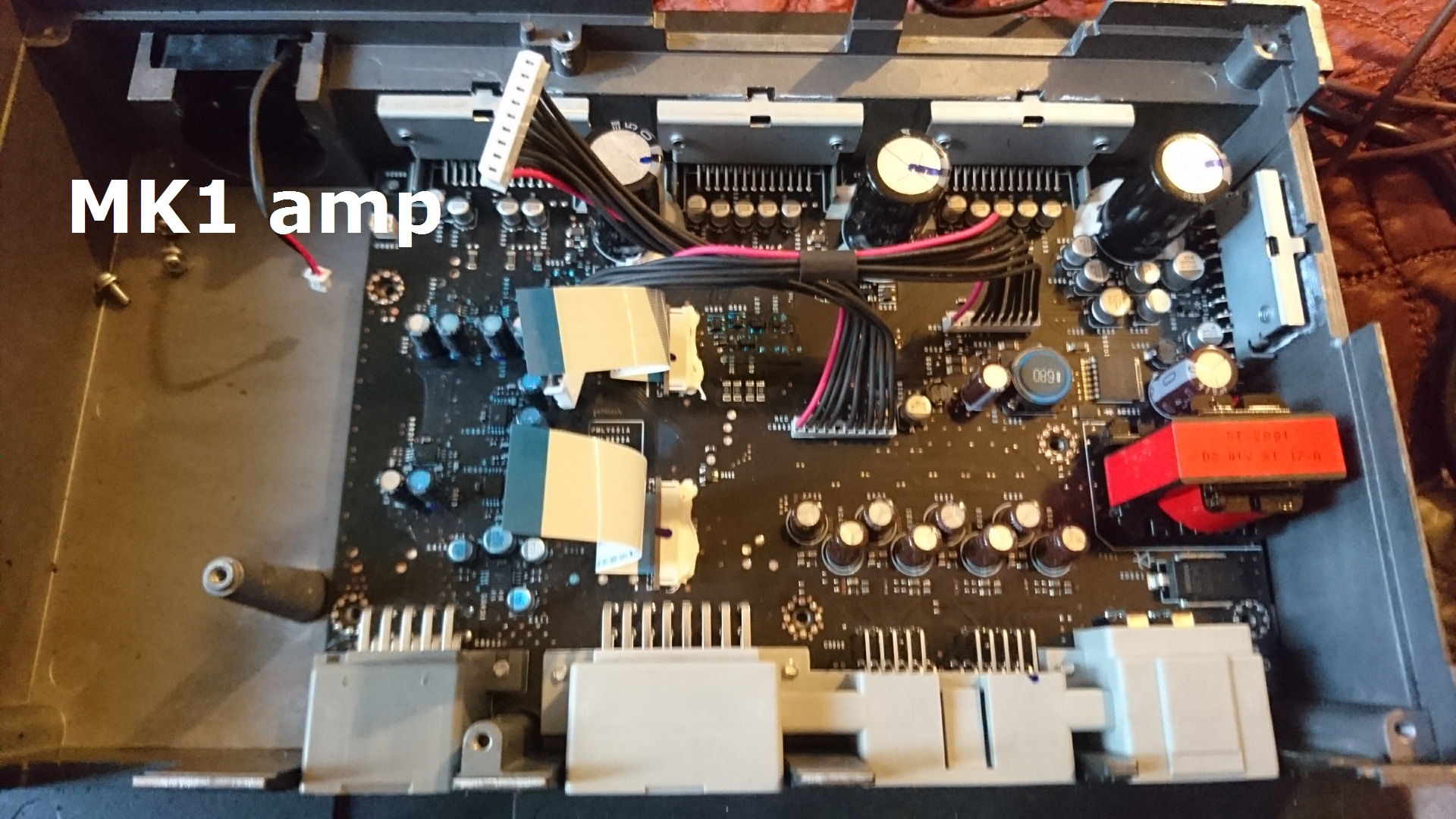

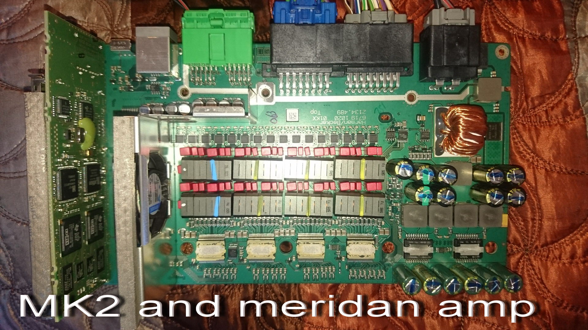

amplifers is very diferent in conctruction,mk1 uses Toshiba 4 channels chips , mk2 is compelteyl diferent( with loadresistors). actually power declarationof 440 B&W syuseis quite realistics each channle 44wats attolerable THD.1200W numbers took from the sky (or probbaly added tweeters/coxials and increased midranges voicecoil)

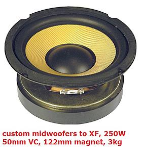

I measured spaces and its inceribly perfectfor instaling big drivers depth I to glass is whooping 95mmand I will fit hughe 7 inch midwooferswith 6 x more power handling(4 layers voice coil, magnet size is 122mm, of course all doors will be bitumen coveredand pastics strengtened because evenstock midwoofers ratles door. I install all new midranges which I wil built custom formyself needs from scan speak and focal parts.I will also instal hughe 35mmfront tweeters with 420Hz Fs and moove midrange to high xover from4khz to 1khz. which make system soundvery audiophile.will use MK2 rear shelf which I grint to accept 130mmmidwoofers and in corner of grill 20mm dedicated titanium tweeters. rear dorrs will have 3 inch lower tweeterupper mid crossed to 500hz with midwoofers. idealy I would wantcoxial but not sure if fit(one member toldthat fit here coxial)

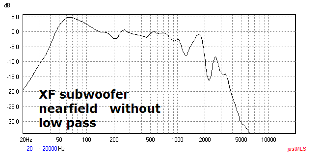

I abandoned second shelf with free air subsidea as new 4 psc 7 inch powerfull wooferswillhave way more bass than stock subs. but I willhave remoovable 85liter 2x 13 inch focal utopia 33WX subs with extra amps with real800W (4000W) amps for the fun.

- SUBWOOFER- Mk1 have foam surround,Mk2 have rubber surrounds. otherwise identical.

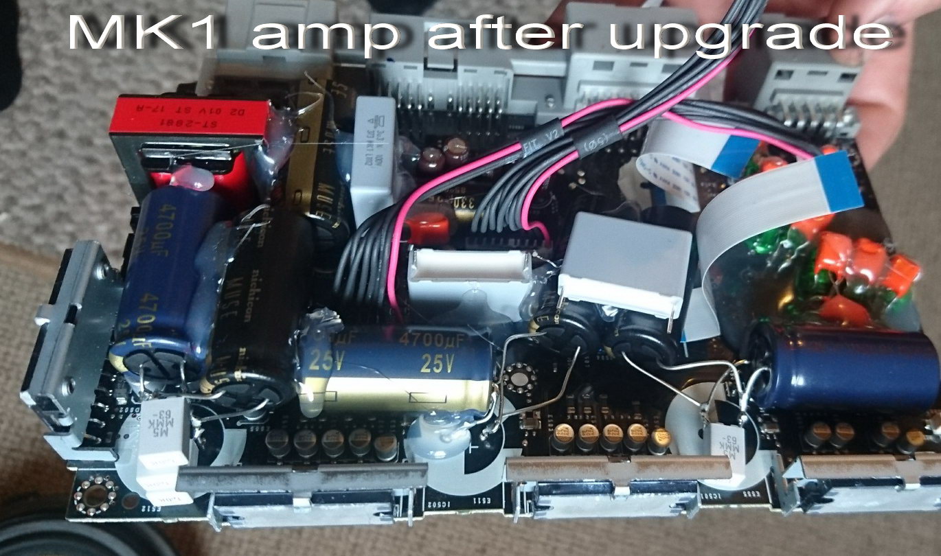

I have also upgraded IAM head unit an mk1 amp(see pics) with Nichicon KZ, panasonic FC and muse bipolars, also shunted with MKP caps, changed few voltage regs to better ones after upgrae not so much space left.

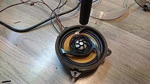

Parcel shelf interchangeable on all x250 but you CANT use facelift model mk2 shelf to MK1 system even if the plugs go straiht in, polarities is reversed. it was surprise for me. all rears and centers is coxials from facelift model. I have bought meridan black poly coxials for testing and how they comepre to mk2 yellow kevlar units. hope this helps.
