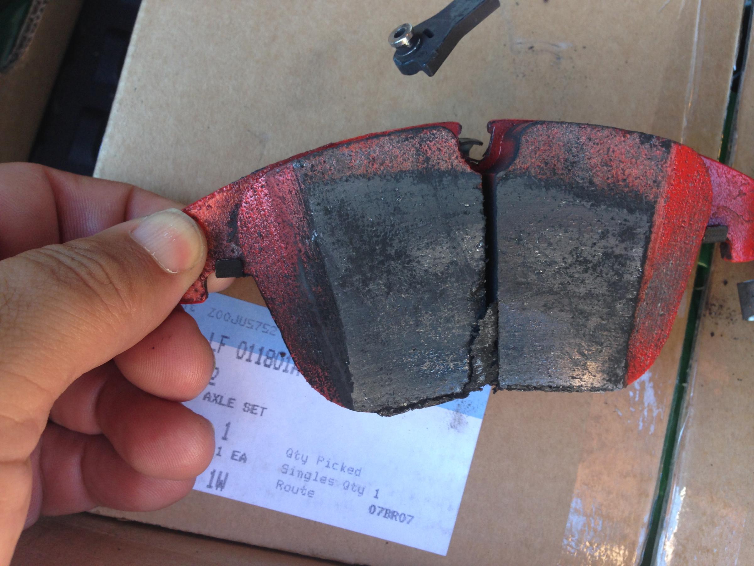

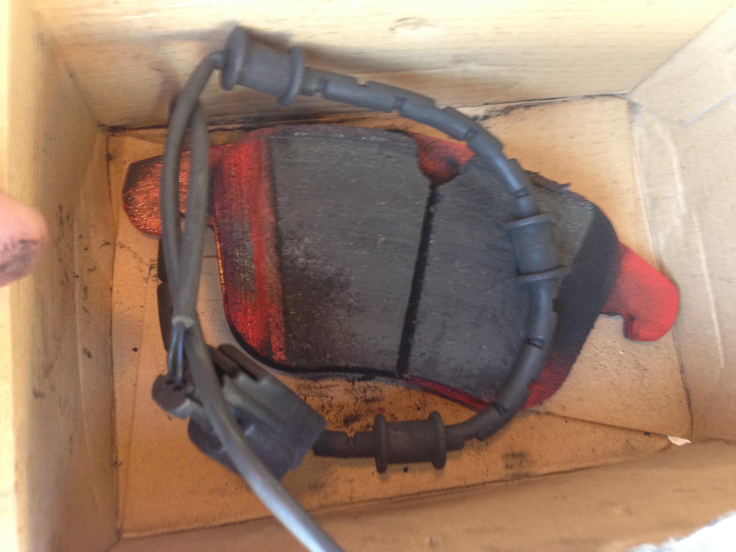

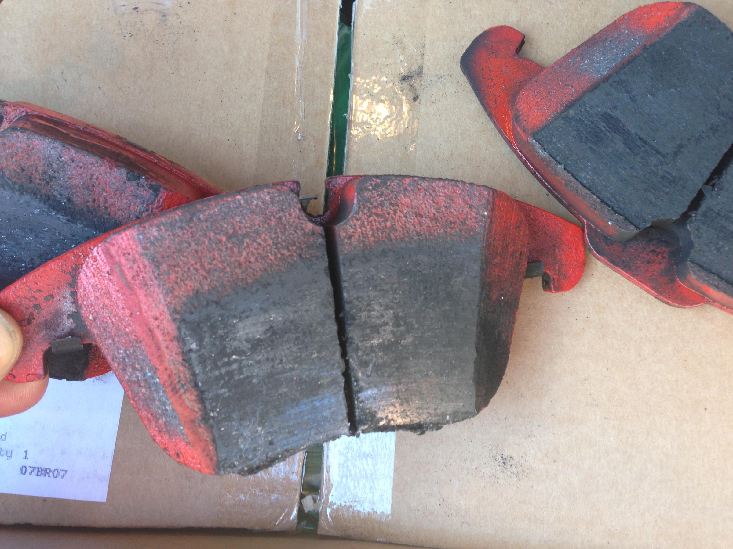

4) The Front EBC pads, while installed correctly, they only engaged three quarters on some of the PADS. Okay so I dropped them and got OEM front pads ($$). Pictures attached (look at the 2nd one closely)

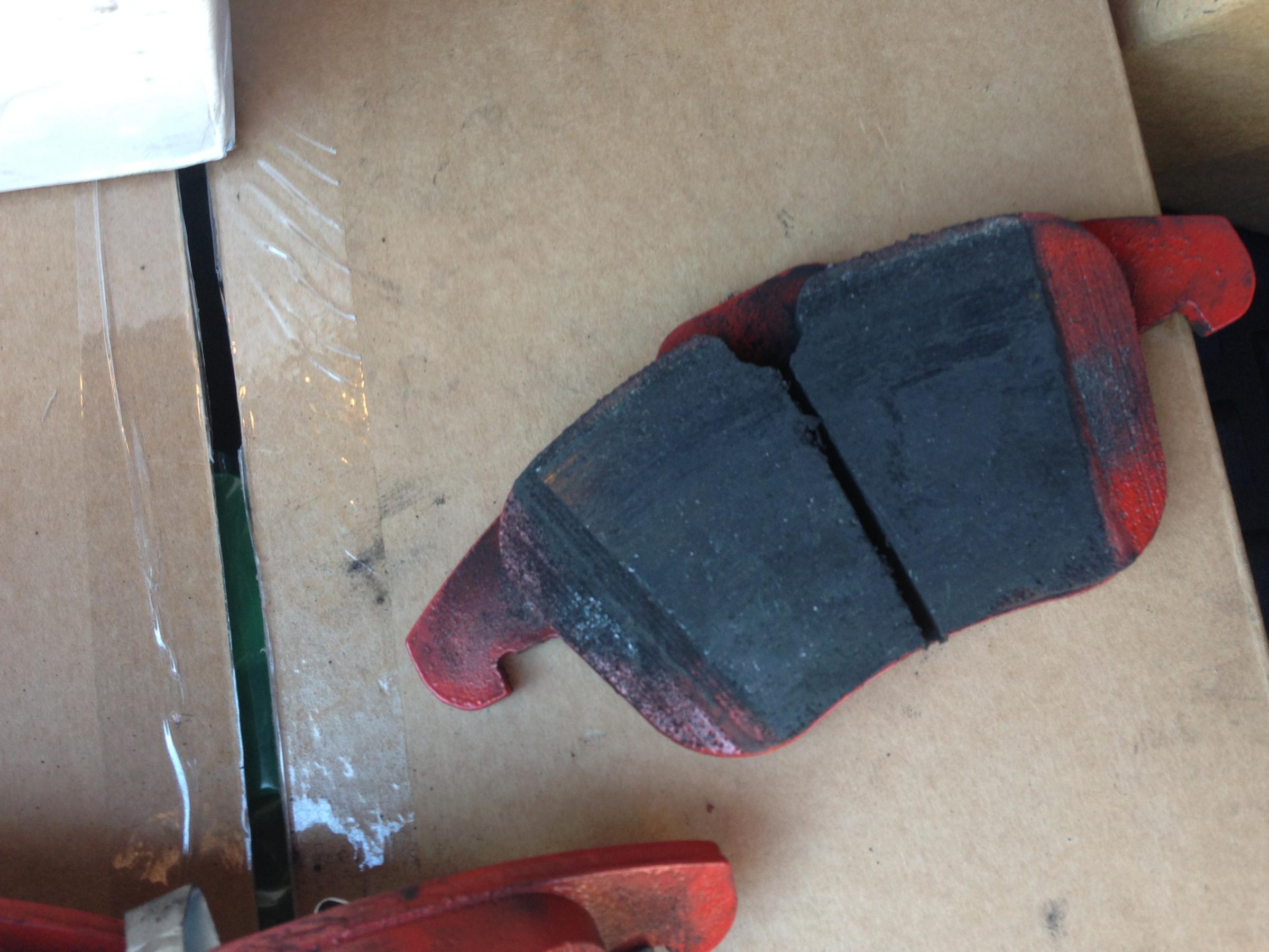

6) After market shop had re-installed some stuff incorrectly (see picture 4)

As mentioned, it looks like either wrong pads or a mis-alignment due to a bent or missing clip perhaps. I always do my own brake work because I don't trust anyone else to do it 100% correctly. Plus I like to get my hands dirty
