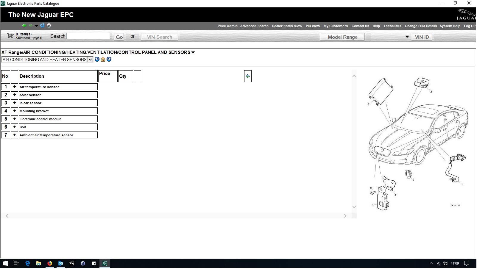

As an Englishman who has owned many different Jaguar models and driven them from the cold north of England to the heat of the French and Spanish Mediterranean, I have always felt the AC is best described as 'adequate'. By contrast, my previous Bentley Continental R and current Continental GT can be freezing cold when the outside temperatures exceed 100 deg.
The refrigerant in your 2011 will be R134a which superseded Freon several years ago. R134a is soon to be banned in Europe although it may still be allowed in the US.
As lotusespritese advises, with a suspected fault, the system should not simply be topped up. It should be evacuated, pressure tested and then filled with the recommended weights of refrigerant and PAG oil. The AC in a Jaguar will normally lose around 5% refrigerant per year.
The AC outlet temperature is determined by a combination of three sensors:
A/C issue-ac-sensors.jpg
(double click on the image to enlarge it)
The actual temperature inside can be measured with a thermometer at the outlets. If it is definitely not getting cool enough then suspect the external ambient Air Temperature Sensor or the interior Solar or In-car Sensors may be faulty.
Attachment 215069
