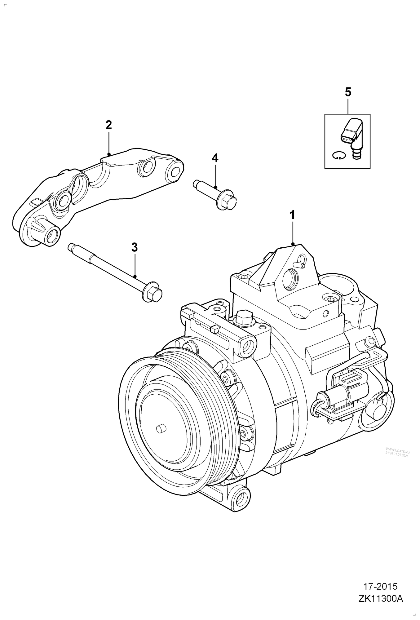

No clutch !!?? So i guess there is no power to compressor to engage when AC button pressed (its always running) right ?
So found this...
is it number 5 at picture?
Thanks btw

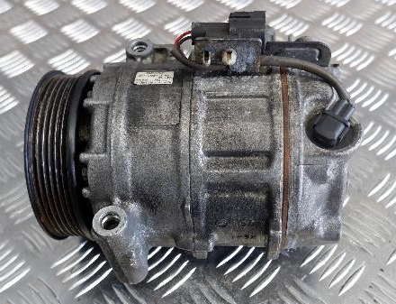

Originally Posted by KKostas
Well , mine compressor is the 8x23-19D629-BA V6D
and doesent seem to have the DPS valve that shows at bulletin.
Well I can, right there on the top/rear!!
