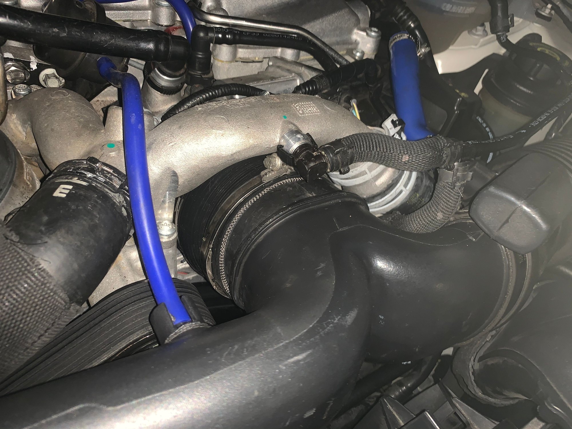

Maybe these videos will help. I don’t have much experience but the water pump area looked dry.. but at this point I have leaks from multiple areas. I went for another drive and came back and removed the intake tube for a better look. It looks like it’s coming from another pulley. I’m trying to track it when it drips and I haven’t figured out wha would cause the leak from down there or anywhere. If you guys still think it’s the water pump then I’ll order one. When the car starts cooling down then that’s when it leaks the most. Two videos for a better look.

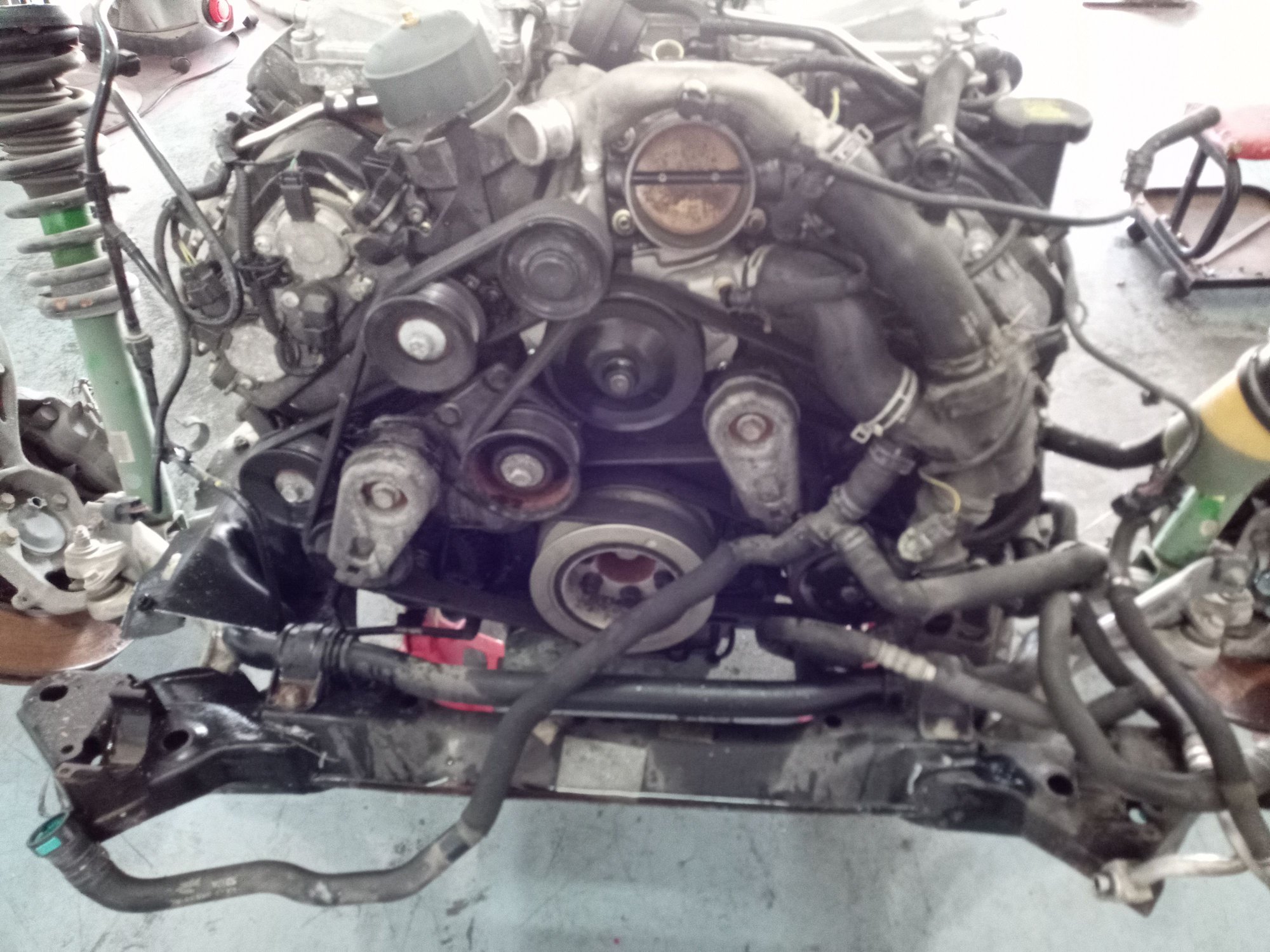

Mar 1, 2021 | 05:51 PM
There's a "Y" pipe that comes up from the block, a smallish diameter rubber hose that runs from the rear coolant manifold, under the supercharger and connects to the throttle body IIRC and a short pipe with O rings that connects the oil cooler coolant outlet to the water pump. To check if there's a leak under the supercharger, peer down the gap either side of the throttle body and you can see down into the "V" of the block. If it's wet with coolant down there then it's likely one of those. My money is on the "Y: pipe since it's one of the 2 piece welded parts that are known to fail. For the "Y" pipe and small rubber hose it's a supercharger off job but don't be discouraged as it's not too bad of a job. You can change the oil cooler to water pump pipe by just removing the water pump. I did a write up a couple of years ago showing the parts that need changing so take a look under my posts.

Now I’m trying to figure How what hoses are under the thermostats. Is there a lower radiator hose that goes up the the thermostat? Or are there multiple? I can’t seem to find a diagram that I can understand to help me figure out what hose(s) I may need to replace.
seems to be somewhere right under the thermostat.

Mar 31, 2021 | 06:58 AM
Don't know if this will help.

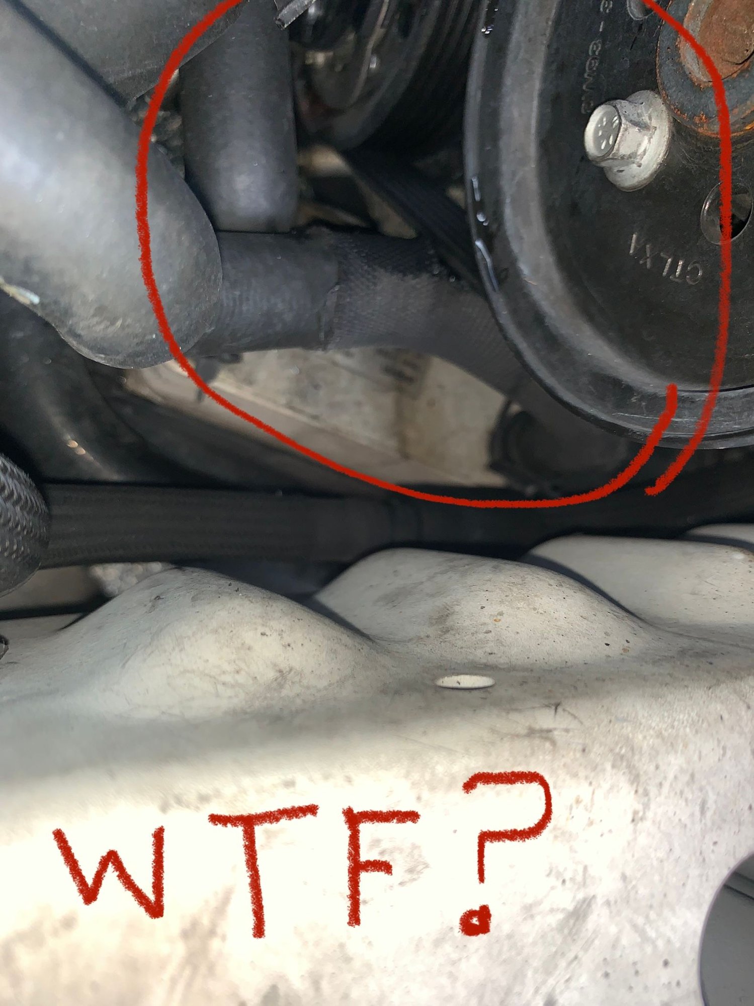

Went to oriely auto parts to grab a pressure tester. They handed me a basic kit and I said I don’t think that’ll work. The guy behind the counter said “no it’ll fit, it’s universal”. I look at it and I’m thinking no way. But I have no choice because they are the only ones with a multi piece pressure tester within 20 miles.
go home and surprise! Doesn’t fit. Like I thought. Well at this point I’m annoyed and just decide to start the car and let it heat up and build pressure. Once it got hot enough it started squirting coolant. I quickly take off everything out of my way and put my hand down until I can feel the water squirting me. It’s hot but worth it. It was kind of hard to feel it without being able to see much.
You will not believe it. I found the source of the leak! It is the craziest thing and now it makes sense. I don’t think I ever had a leak at the water pump. I’m glad I did it because it looked like it was replaced before but without any markings I’m assuming it was maybe a cheap unit. The oil cooler to water pump tube was also installed incorrectly.
I don’t know how this happened... but....
the hose from the radiator to whatever cooler it is down there was sliced by the belt. I don’t know why. Maybe the previous owner had some work done and it was installed incorrectly? Or maybe warping from all the heat? Either way, I’m relieved. Shouldn’t be that hard to replace right?

Apr 1, 2021 | 07:31 AM
Yep, bad installation most likely. Well found. Lots going on down there, have to keep everything away from the belts. Jag fitted lots of clips, for good reason, workshops probably don't bother putting them all back on.

Apr 9, 2021 | 08:50 PM
Update: finally got everything put back together after not driving the car for a while now. It was a pain in the butt. Someone definitely did work on it. Not only was there a clamp there but someone zip tied on top of the clamp. Trying to take of the clamp was filled with a lot of frustration and curse words. But after purchasing some tools that helped me reach that location I was able to get it off.
my intake tube was no longer usable since it was basically cracked at the throttle body. so after some trimming I used a coupler as a temp fix

Apr 22, 2021 | 07:08 AM
My XFR had the same leak on the trans cooler pipe. It was only $28 hose from the dealer but thankfully my brother worked for Jaguar as a tech at the time and fixed it for me. I had him zip tie the new one away from that belt. Apparently they lose their shape over time and shift into the belt.
