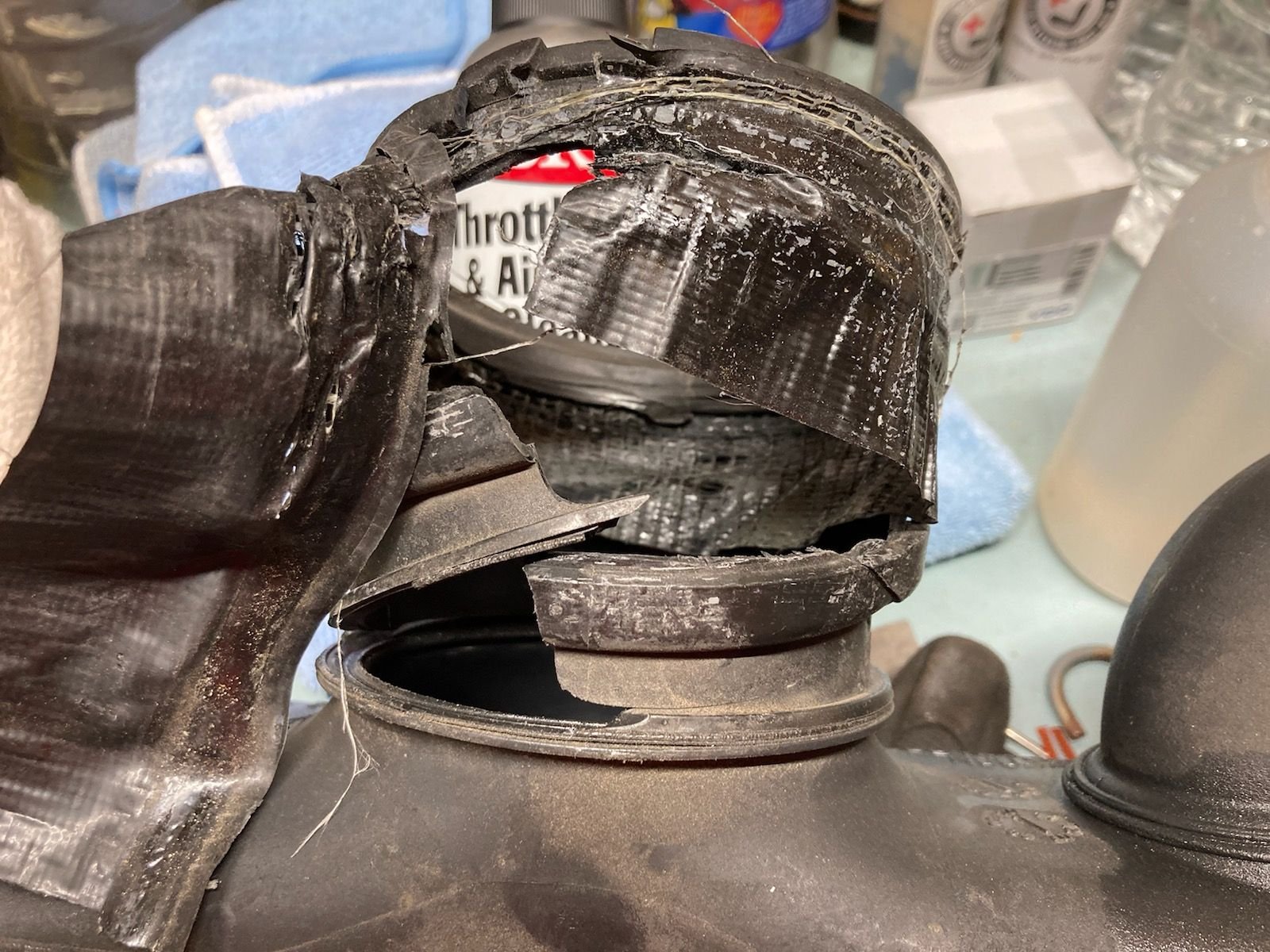

Would you guys be kind enough to post pictures of the cracks and also of the installed mina tubes

Sitting on my bench
It was stuck at the throttle body so tore a little more getting it off, but it was very bad to begin with. And yes, that duct tape was the previous owner's version of a fix.
Installing the Mina pipe was pretty straightforward. It was tight attaching to the air boxes. If I was doing it again, I would have loosened/adjusted them first for easier fitment.
