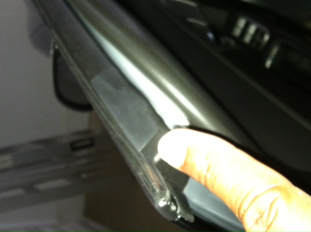

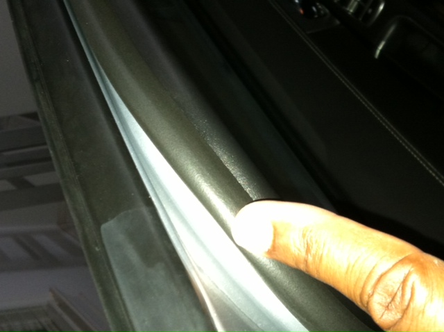

Here are some pictures of the "correct" and "wrong" seals... Hopefully this helps others with the same issue with less trials..
Door rattle-correct-seals.jpg - Correct seals causing noise - replaced
Door rattle-wrong-seals.jpg - Incorrect seals, not causing the noise

I have a 2010 model year XF, and it would seem I am the only person from the UK experiencing this issue on this forum.
Can I ask the Seal that was replaced, was it the seal that goes right round the door and just the strip along the top of the door, which is part of the chrome strip which sits on the utside top of the door? Also would it be possible to provide me with the details of your dealership in the U.S, so that I could contact them in order to provide some inormation to my own dealer in the UK on how to rectify the problem.
