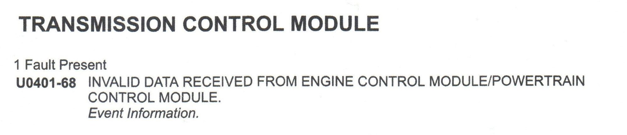

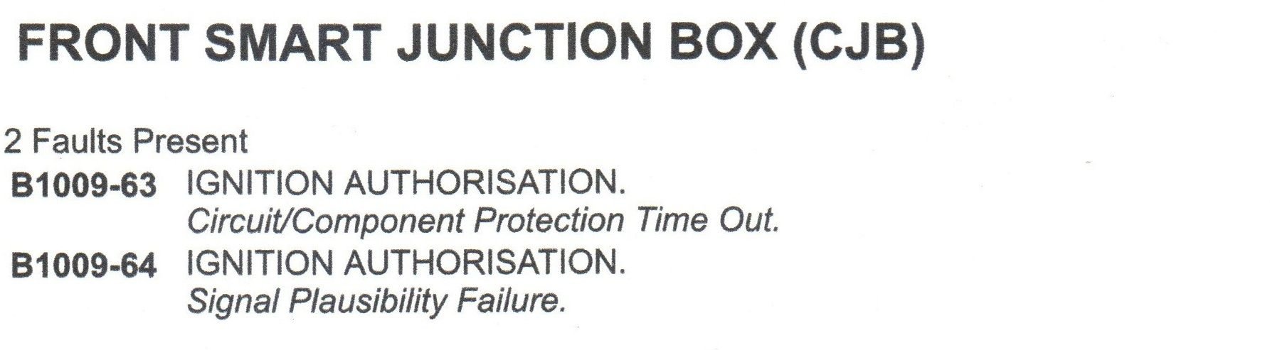

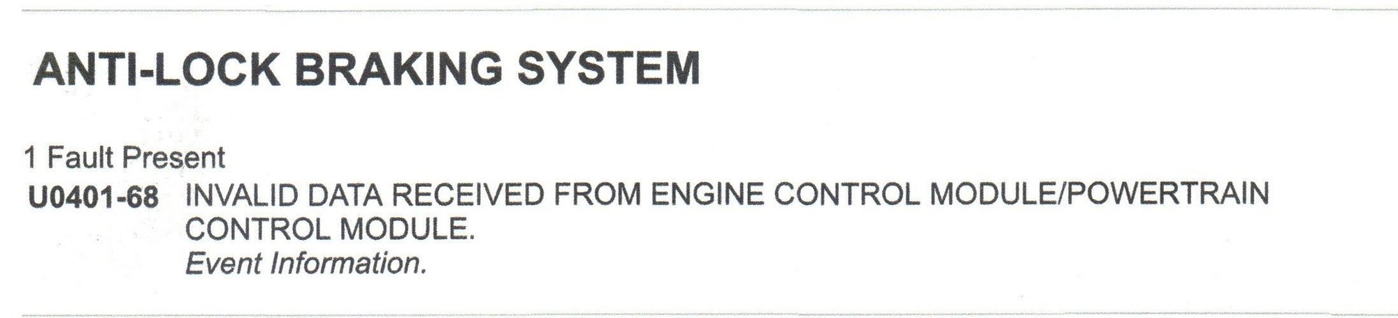

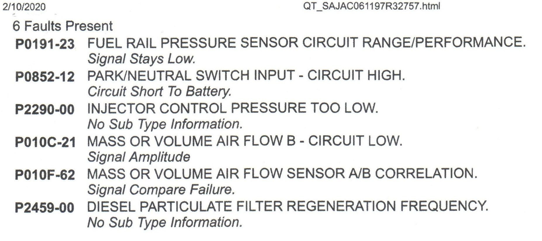

Took it to have a diagnostic and it has come up with the folloring faults in the attachments (there were a few other faults not related to the running of the car so not included them).
So my question is, any ideas what could be causeing the fault, any suggestions how to go about fixing the fault

Hi,
I have experienced a very similar situation as described.
1) DSC and Restricted performance: Took me a month to solve. I changed MAF and looked for air leaks. It was not the case for me, but usually, it is for the majority. The case for me was that one of the TURBOS (drivers' side) seemed to stuck while accelerating. Cleaned the "movement axis" (sorry I have no idea how to name it properly) of the faulty Turbo and the problem was solved. I was told that it might be that the Turbo itself needs replacing. But the cleaning procedure fixed it.
2) Car not starting. I have experienced the same, however, I found out the problem was that the fuel pump was on its way to stop working. Nevertheless, the car sometimes started, sometimes not. Now it starts fine. I did not change anything since fuel pump replacement might be costly, so I wanted to make sure it is the case. How were you diagnosed that your high-pressure fuel pump is faulty?
