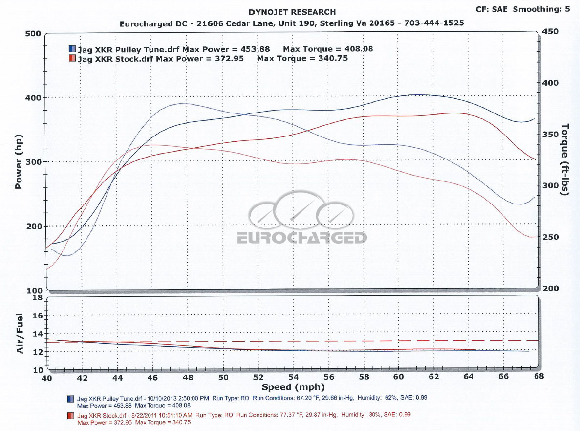

Looks like the shop beat you to it.. they put your dyno run on their website.
Now I don't know much about these charts.. but how come the numbers don't match the graph? Are they factoring in the loss between engine and rear wheel?
Yeah that is a really odd graph. It looks like you actually lost a bunch of power and torque on the lower end and it pushed your power band up and to the right. The numbers definitely don't match to the graph as mentioned above though. Definitely a nice peak power gain!
Have no idea why the graph scale is off on the left/right side.

I was not present for the dyno run, so I can't say for sure how things were done. I was told this was done in 3rd gear in "Sport" mode with Dynamic on. The results are odd because the end of the run spiked to the listed readings but they shrunk the graph so this does not appear on it. I believe this is due to some inexperience and a possible mistake at the shop. Therefore, they have agreed to run it again now that I have new tires on the car. I am scheduled to have the run done on Monday morning. Hopefully, we have some results that can be posted with more confidence.

I just did a Google search on the 2010 XKR and the ratio for third is 1.52 and 4th is 1.14. They should run in the gear that is as close as 1:1 as possible...so 4th. I believe you will see higher numbers in 4th as well.
But, they may be running in 3rd because I just read could be considered safer as it has a shorter run time and lower top speed.

Couple things i noticed, 1) the bottom of the graph SHOULD BE rpm not mph
several tuners and dyno operators i know and use do not pull in 4th but 3rd. The dyno speed at full rpm pull in 4th is a very high mph. Anything lets go in the drivetrain and its severe. 3rd gives accurate results with less risk.
Spiking up after dyno? Looks like its on its way down to me and no reason to go up. Even if it did and i was claiming those numbers i would post it.
Dynos of eaton always show drop off about where shown. Increasing boost does (should) bring boost in not only sooner, but less trail off up top of boost and power. But as you turn them up so does youre heat and parasitic losses. When i went from a eaton to kenne bell the dyno showed no drop off of power or boost and was still going up at 7k redline. Not as steep, but still upward where the eaton had dropped longer before in power and boost. Peaks between the 2 were 10psi eaton and 12psi twin screw. But a 100 foot pounds more torque at 3000rpm at the start of the pull for the kb.when i see dynos with incorrect info. Missing numbers etc i suspect further foolery.
fyi i have installed lots of stuff over the years that never lived to supplier claims for me. Some alot lower and some power loosers. Its always a good rule to use the same dyno operator and dyno doing baselines and dyno as you go. Yeah more expensive, but if results and accurate info is what you want then youll see the patterns. I picked up 50rwhp just switching dyno's with same setup.

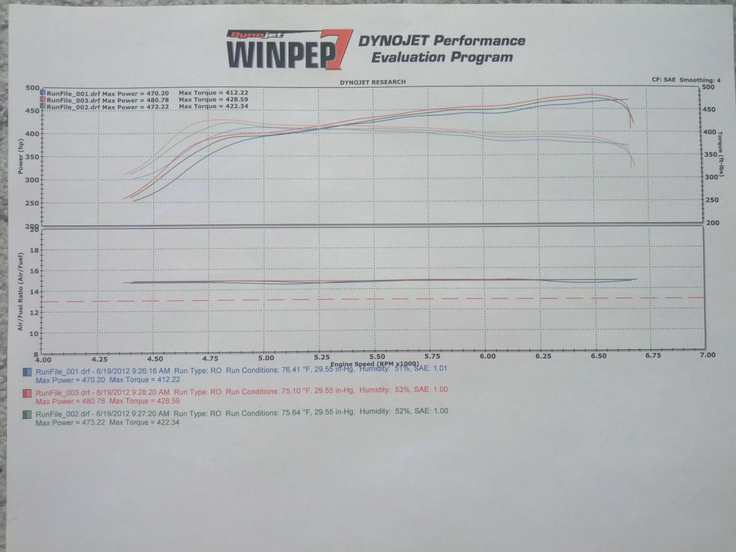

I don't know much about AFR except that if it gets too high, it goes boom. What ratio is too high? I went back and researched BigCat09's dyno curves (attached) and I noticed his were at around 15 all the way across. But I couldn't remember if he took AFR with his runs or not?
The dyno runs that USMAXKR2010 posted all look to start at 15 and then go down to 12 at about 5K RPM. Can anyone tell me what is safe? I've read other places that 11.5 to 12 is perfect. I'm soooo close to getting the Eurocharged tune and I think this will be the last question that needs to be answered before I'm in.
