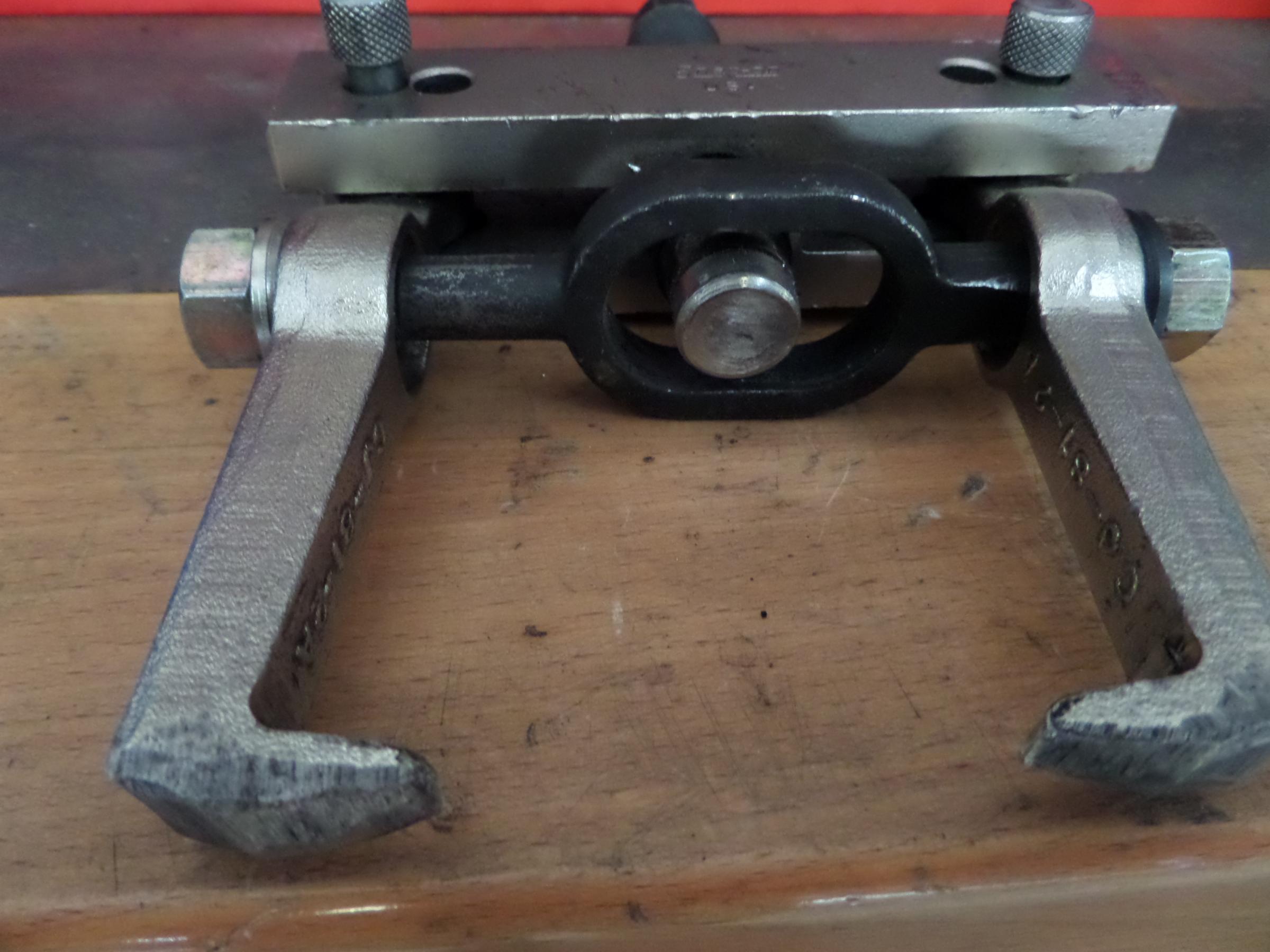

Default EuroCharged Pulley Puller Recommendation
Here are the photos for the pulley puller EuroCharged recommends. They say a few still get stuck on though and you have to cut them off. Hope I'm lucky.
Attached Thumbnails Eurocharged ECU tune and pulley combo-pulley-puller-1.jpg   Eurocharged ECU tune and pulley combo-pulley-puller-2.jpg
