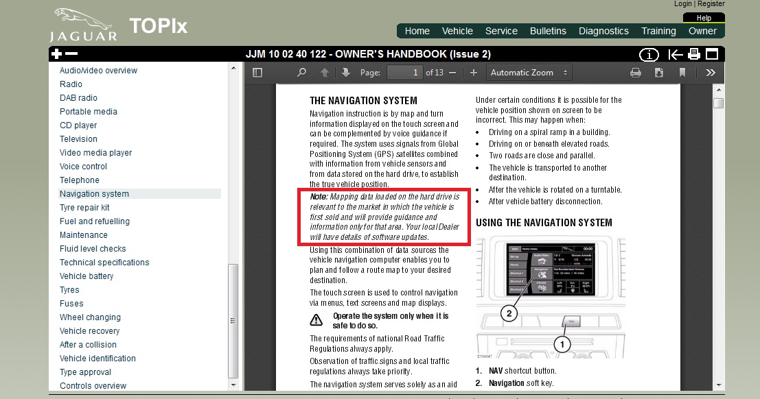

CD or DVD discs are not used by the 2012 Nav system. It is updated via a USB flashdrive. Suggest you contact Jaguar UK or a local dealer to determine what may have to be done, if anything, to make the Nav system compatible for a European update.

CD or DVD discs are not used by the 2012 Nav system. It is updated via a USB flashdrive. ...............
So it is.
Updates for the earlier DVD system are expensive. This one could need a second mortgage!
