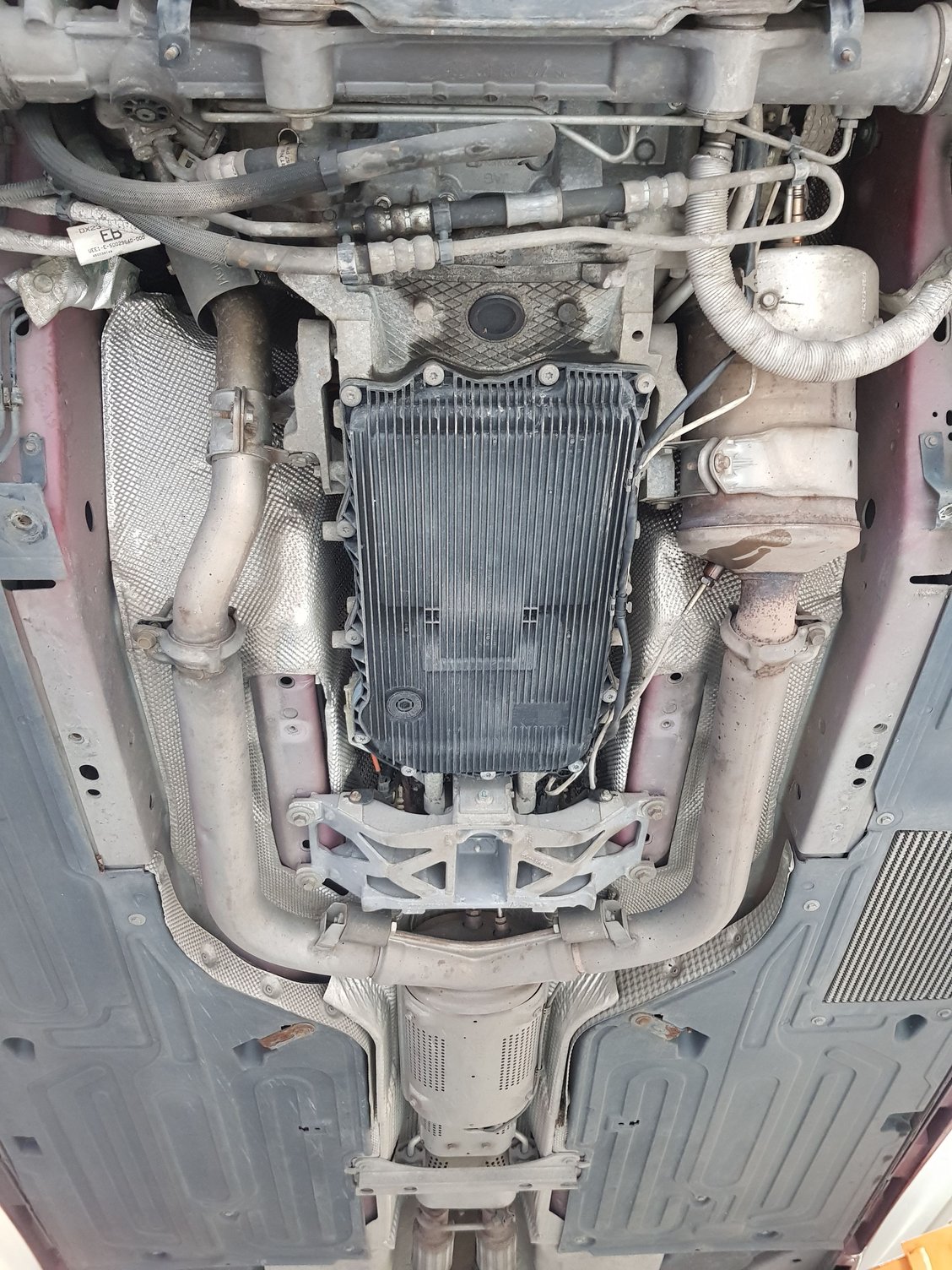

Another thing I discovered was that there were 2 turbos, I thought the 240bhp was a single turbo.
Also it has only one cat, the passenger side one. I took some pictures. The tuning guy was surprised but said it didn't look like anyone has played with it.
Any ideas?????

when looking at the image it looks like you worked on the cat, not on the particle filter. Which sensor did you replace?
Chris

As I said in the description, the post cat temperature sensor got replaced and from what I have been told so far, it should have been the dpf temperature sensor.

Looks like there's a fluid leak from the transmission pan seal too (or is that from the rear crank seal and just collecting at the lip of the pan?), just FYI.
I did have a bit of an oil leak from the sump bolt which was not tightened properly from the last service. It was only hand tight which was a bit worrying...

Graham, looking at the exhaust diagram above, I cannot work out which number is the particulate filter inlet exhaust gas temperature sensor.
Is there a part number for this for me to search for a new one?
Google searches seem to bring up different temperature sensors and when going on specific web sites, they are not specific about where their particular sensor goes.
Maybe it is a main dealer part only...
