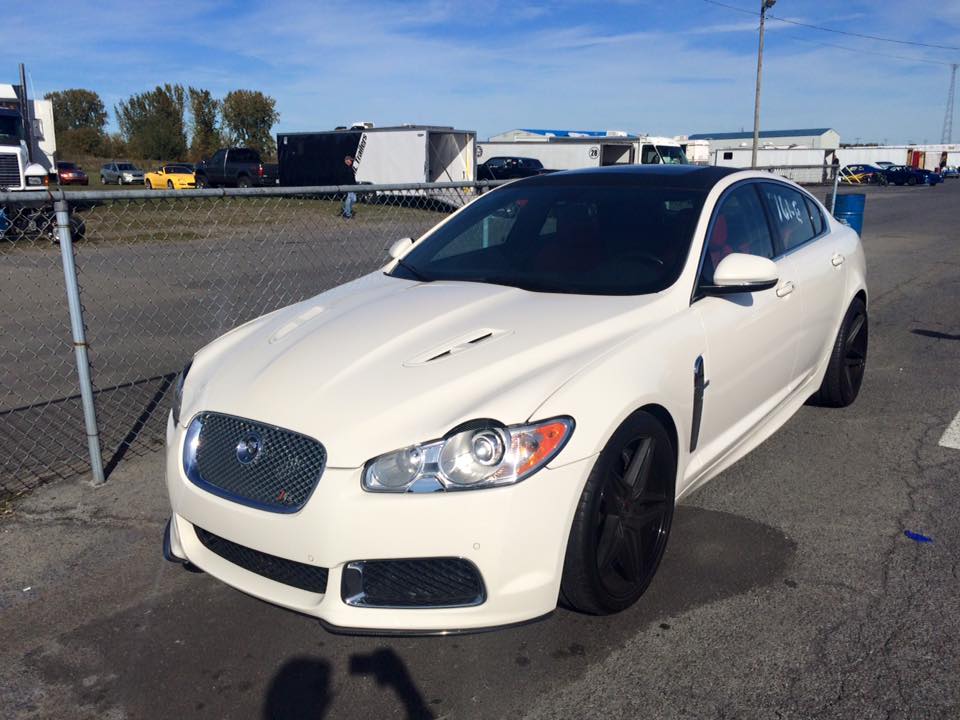

I finally got to try my 2010 Jaguar XFR at the Drag strip yesterday. The car ran a great ET 12.55 with a 1.83 60ft, which was great. But I was really disappointed with the mph, 111.44 on that run and a 111mph on every run with a best of a 111.93. I really thought the car would have more mph than that. With all the articles that I've read in magazines ranging from 12.9@112 to a best of 12.60@116 , I was really off in mph. The air was cool 16 degrees Celsius , not warm enough to lose HP. The car is stock with 2 K/N air filters and a Mina axle back exhaust. Sometimes I begin to wonder if the car would have ran better with the stock mufflers. My 2004 Jaguar S-Type R ran a best of 13.27@105mph bone stock, and when I put the Mina cold air, Mina pulley (1.5lbs of boost more), Mina axle back, I was never able to beat the time of the car bone stock. Do you guys let the tranny shift on its own or do you shift it yourself? I was letting it shift on its own on sport mode. I would like to have your opions on this and what you guys think.
Thanks, ahead of time.
Marco
Here are some pictures of my car:
Attached Thumbnails Finally tried my 2010 XFR at the drag strip-xfr-track-day-rear.jpg   Finally tried my 2010 XFR at the drag strip-import-show.jpg   Finally tried my 2010 XFR at the drag strip-xfr-track-day.jpg
