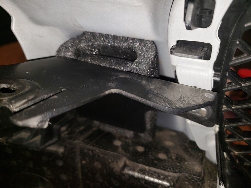

I had some insulating pipe foam laying around, so I unscrewed the black plastic from the bumper, cut two (2x) 4-5" sections out of the 3' foam tubes (one for each side of the grill), opened them up at the seams, pulled the black plastic out and away from the bumper a tad, slid the cut foam vertically between the bumper and the black plastic, and then put the screw back in, so the black plastic would then hold the foam in place. See additional pix below for reference.

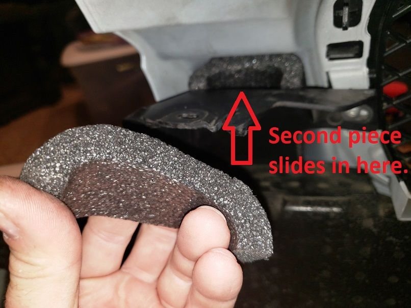

Then, to fill the gap between the first two vertically mounted foam sections on each side and the black plastic pieces on each side, I cut two (2x) ~1.5" sections of foam out of the original 3' foam tube (now only ~2' long after cutting out the first two vertically mounted foam sections), opened them up at the seams, and slid them between the black plastic and the already inserted vertical foam pieces. As all sections of foam wanted to resume their original tubular shape, they kind of wrapped and grabbed the black plastic on top, bottom, left, and right.
Second foam piece goes in horizontally
Voila!
I guess I could've used some mounting tape or some kind of mechanical fastener, but I'm pretty sure they'll stay in place without it.
Best $0.50 I've spent in a long time.
