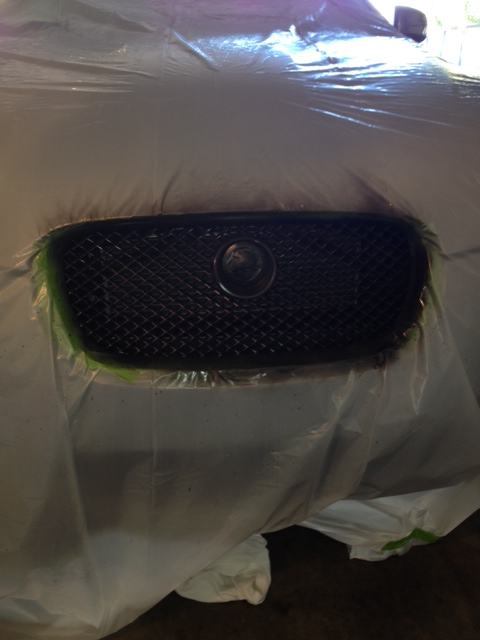

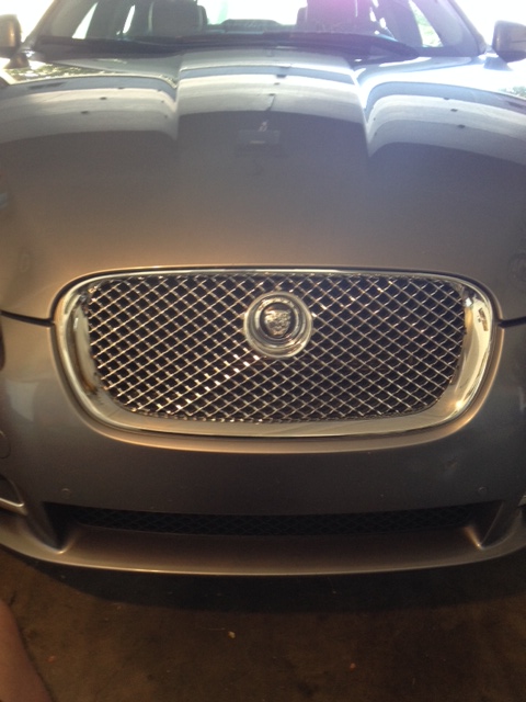

Grapeman- you are correct in thinking the longevity of painting the grill will only net short-term results. I gave it a go and was pleased with the results until I noticed road grit essentially sandblasts the paint. I can see chrome pin points breaking through the black paint. I used a wax/degreaser, bond promoter and multiple light coats of paint. I suspect only an automotive grade paint is up to the task. Mina, here I come....

That's the exact reason why I went the Plastidip route. I have had not a single rock chip or scrape in 6 months since I have done it....debris just "bounces" off of the dip.
