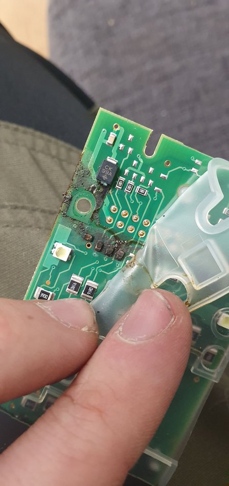

Old Dec 14, 2020 | 03:13 PM
Tomy49492's Avatar
Joined: Aug 2019
Posts: 25
Originally Posted by joebit
Hi all, Has anybody heard or seen problem with the XF sv8 gear selector stuck in up position when car is turned off. Error code U101B when i scan.
Thanks
Joe
I had a female spill her drink on my shifter which next morning it fried the circuit board. Order used one on eBay and work $250
