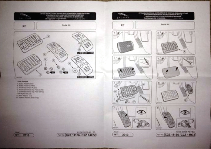

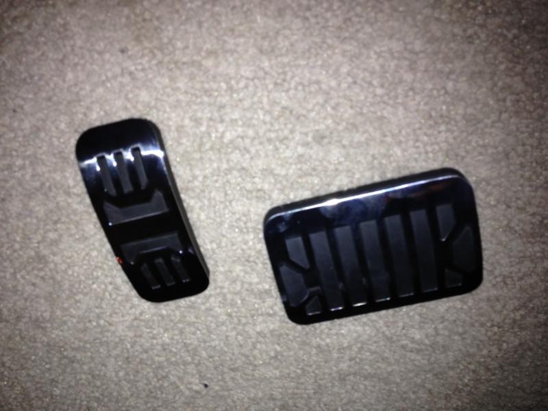

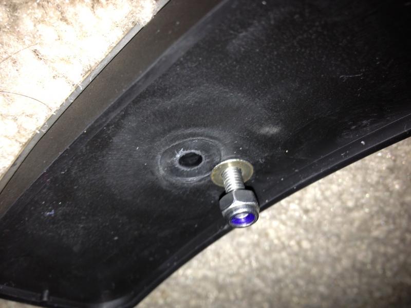

I saw the same thing on the website. However when I opened the box, the instructions show one hole to be drilled on the gas and two on the brake. I'll post detailed pics as well when I get a chance.
Attached Thumbnails Help installing stainless steel pedal (official accessory) on 2012 XF-photo-1.jpg   Help installing stainless steel pedal (official accessory) on 2012 XF-photo-2.jpg   Help installing stainless steel pedal (official accessory) on 2012 XF-photo-3.jpg   Help installing stainless steel pedal (official accessory) on 2012 XF-photo-4.jpg

The rest of the photos, with instructions. Sorry for the inverts...
Attached Thumbnails Help installing stainless steel pedal (official accessory) on 2012 XF-photo-4.jpg   Help installing stainless steel pedal (official accessory) on 2012 XF-photo-1.jpg   Help installing stainless steel pedal (official accessory) on 2012 XF-photo-2.jpg   Help installing stainless steel pedal (official accessory) on 2012 XF-photo-3.jpg

I can't get the images good enough to read the instructions. Does the text suggest there's any marks on the existing vehicle pedals to reference where the holes are to be drilled or do you need to measure these?

You will have to drill one hole through the gas pedal because the stainless pedal fits over the existing gas pedal. It's not hard to do because I believe it's plastic material. For the brake pedal there is no drilling required. Remove the old pedal and the holes on the new pedal (with new pad) line right up. 10 minute job in all. You've made a great choice. I have these on mine and even though they cost a lot more than some aftermarket covers, you can definitely see the difference in quality and appearance. IMO, of course.

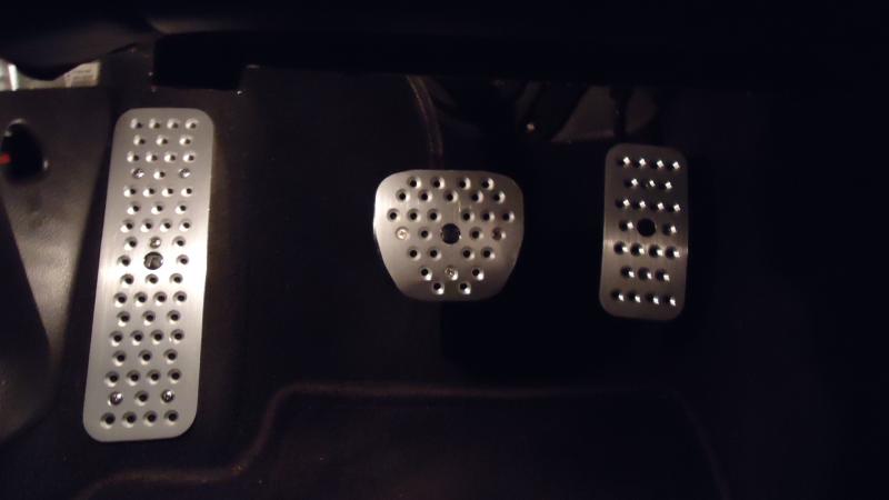

The Mina pedals look really nice installed with the Dead pedal as well, A little more $$ but you get all 3...
Attached Thumbnails Help installing stainless steel pedal (official accessory) on 2012 XF-dsc00348.jpg

Ahh yea those are really nice too. I haven't seen those ones before. They are not on their site. Defeinitely more racer style for a XFR. I still like the OEM ones the most. I do however like the dead pedal covered that you get with the aftermarket ones and that was the main reason I went with the ones in the picture below rather than OEM. But now I have the weathertech mats and it covers half of the deadpedal anyway haha. Have a look. Still like the classy look of OEM the most though.
Attached Thumbnails Help installing stainless steel pedal (official accessory) on 2012 XF-img_1311.jpg   Help installing stainless steel pedal (official accessory) on 2012 XF-img_1500.jpg
